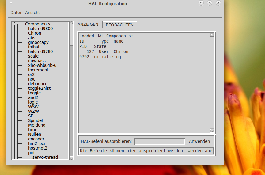

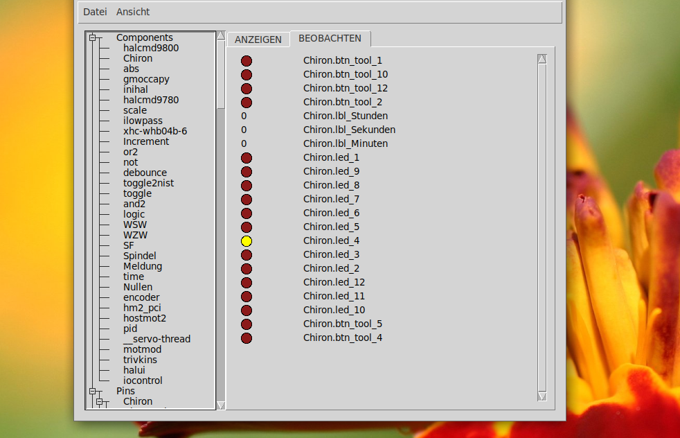

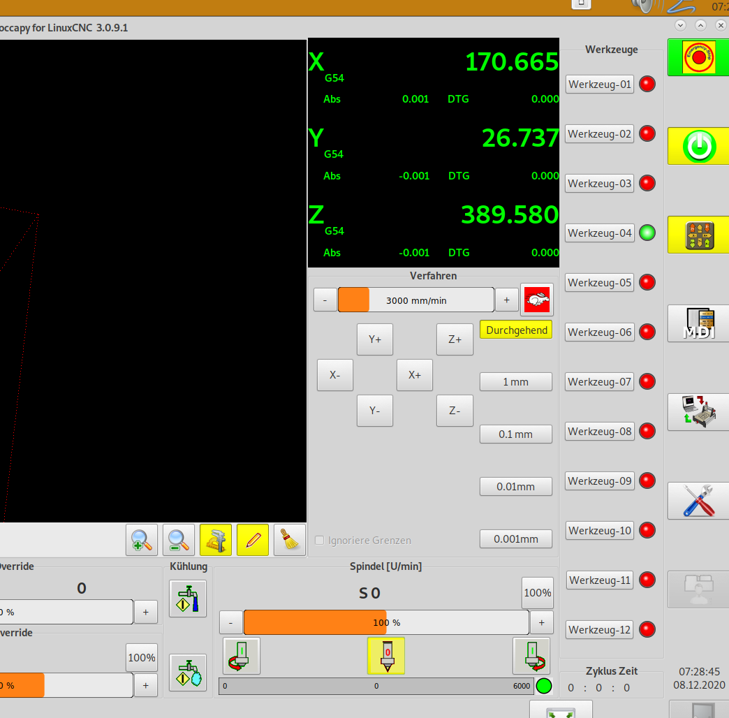

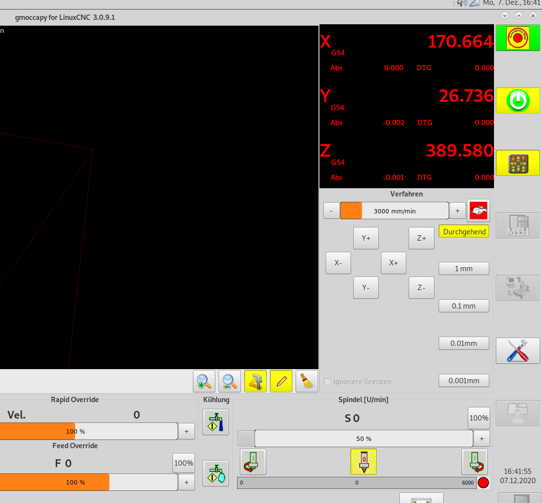

Hallo
I have no idea why Gmoccappy not loads the Glade file ?
Version is LINUXCNC - 2.8.1
[DISPLAY]
EDITOR = gedit
DISPLAY = gmoccapy
EMBED_TAB_NAME = Chiron
EMBED_TAB_LOCATION = box_right
EMBED_TAB_COMMAND = gladevcp -x {XID} -H Chiron.hal Chiron.glade
DEFAULT_SPINDLE_SPEED = 150
MAX_RAPID_OVERRIDE = 2.0
Chiron.hal
[DISPLAY]
EDITOR = gedit
DISPLAY = gmoccapy
Chiron.hal

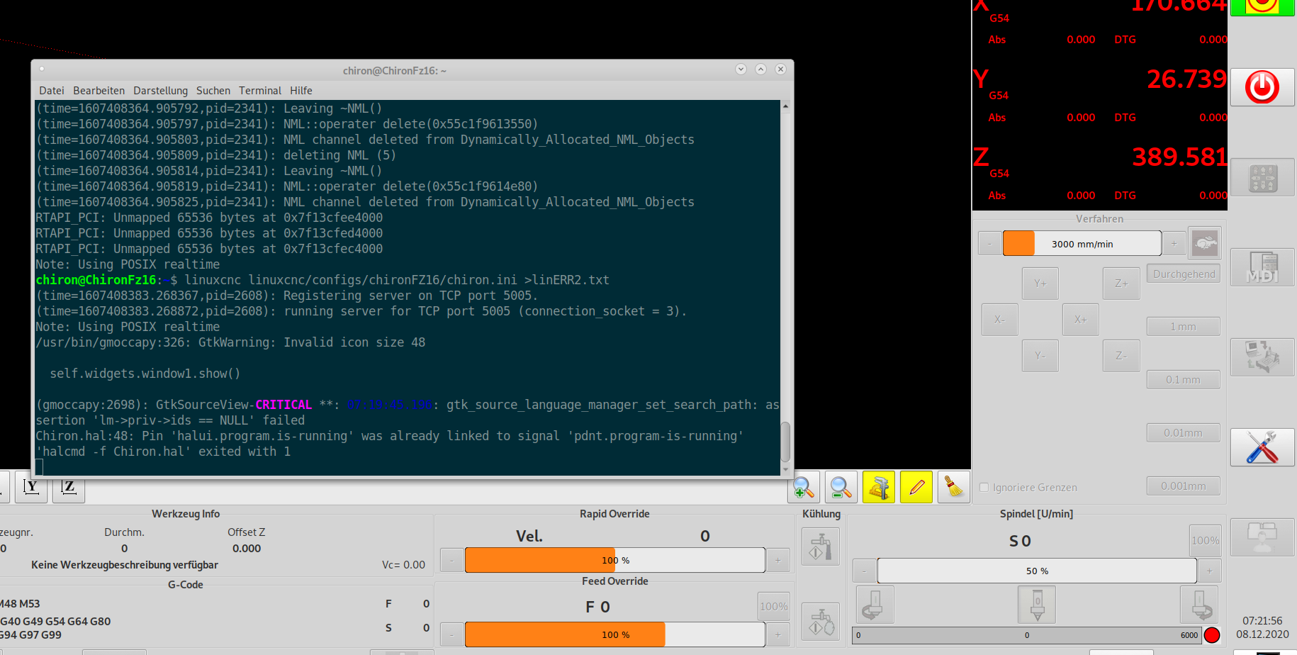

Any error messages when you start from the terminal?

Start Linuxcnc from the command line and report the errors printed in the terminal. This kind of thing will happen if you are missing a component or make an error. Read what is printed and look for the first error. Resolve it and move to the next if there are more.

Open a terminal and type:
linuxcnc /home/user/linuxcnc/configs/yourconfig/yourinifile.ini
Adjust the filepath to match your setup.
Check the output in the terminal window to see if you get any errors.
