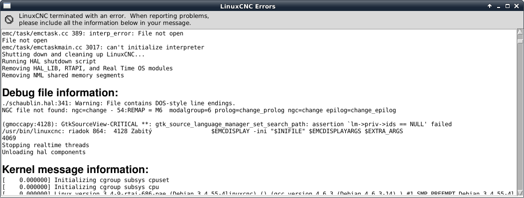

Good day.
I'm trying to configure Tool Measurement in Gmoccapy according to the wiki instructions and I can't do it at all.
when I insert a line into the .ini file:
REMAP = M6 modalgroup = 6 prolog = change_prolog ngc = change epilog = change_epilog
I can't run gmoccapy, and when it's forced to shut down, it prints the following error.
I don't know what I'm doing wrong or what's wrong with my configuration.
can you please advise me what to try, add, delete ...
I am attaching a complete config.
Linuxcnc 2.7.15
Gmoccapy 1.5.11
Thank you very much

You have a typo in your INI File:
SUBRUTINE_PATH = macros
should be:
SUBROUTINE_PATH = macros
You missed an "O"

Norbert, you are incredible. I watch it for hours .... and I'm blind.
thank you very much once again.
