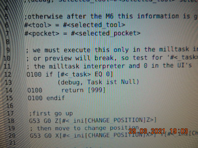

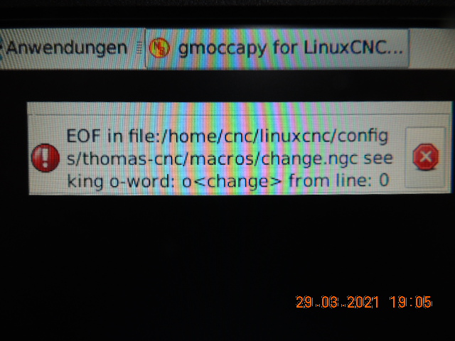

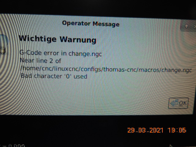

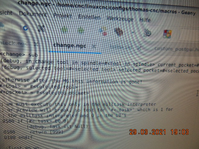

when i select a tool from the list ,an error message appears.
The following debugs are in the macros/change ngc folder.
what can i do?
what can i do?

Did you change the code? The error tells you, that there is an O used in line 2, so if you have changed line 1 the error could also be reported at line 2.
There has been also a problem with case sensitive o-word stuff, may be you just try to change AL uper o calls to lower letter calls.
Norbert
Norbert

i haven't changed anything.
which settings are correct?
the sensor of the WZLS was defective.i exchanged it for a new one,the sensor is now working properly.
could have something to do with it?

IMHO not.
Did you update some time ago?
Have you tried changing the O's in the file from upper to lower?
Norbert
Norbert

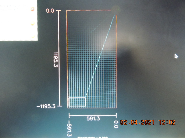

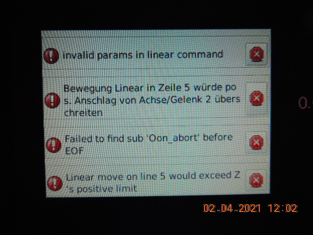

- horntreiber
- Posts: 16
02 Apr 2021 04:26 #204472
by horntreiber
Replied by horntreiber on topic Help setting up/troubleshooting gmocappy on site Schleswig/Holstein home kiel
Hello Norbert
happy Easter
i have changed the O,s to lower. Now the WZLS is working. thank you for your help.

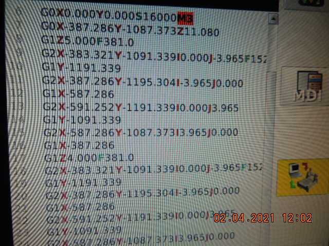

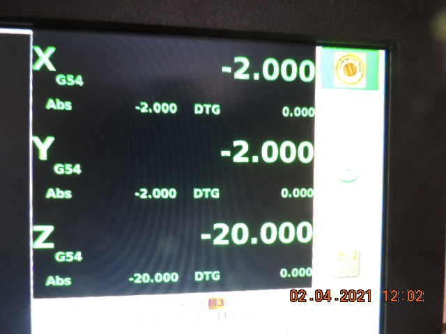

when i loade a test milling job i get an error message.can you please have a look at that.
Thomas
happy Easter
Thomas

02 Apr 2021 16:25 #204562
by newbynobi
Replied by newbynobi on topic Help setting up/troubleshooting gmocappy on site Schleswig/Holstein home kiel
First error: You did not touch off in Z, axis 2 and the code does contain a movement what would excide the limits, so on a machine with 100 mm travel distance you try to move to 120
Second error: invalid parameters just check that line and the one above and the following one for typos
Third error no subroutine on aboard found, check typos, seems to be a wrong entry in your INI file or the subroutine path is wrong or...
Why do you use on aboard? Most times it is not necessary, and apologize, you seems to miss basic knowlage, so you might just have on aboard in your inin, because you read it in a docu or so.
Norbert
Norbert
