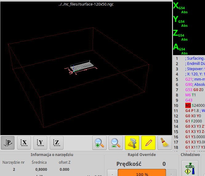

After starting the program, or after changing the preview mode, the perspective preview is set with the default settings, the dimension and the viewing angle are not as I need.
Where can it be changed?

After run program :

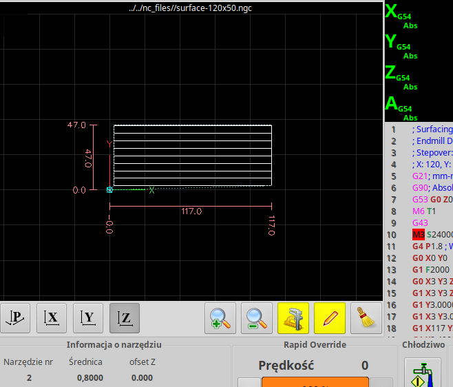

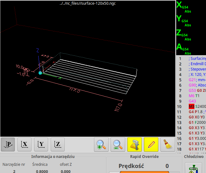

After manual change view (by mouse) :
After switch from "P-view" to "Z-view" :

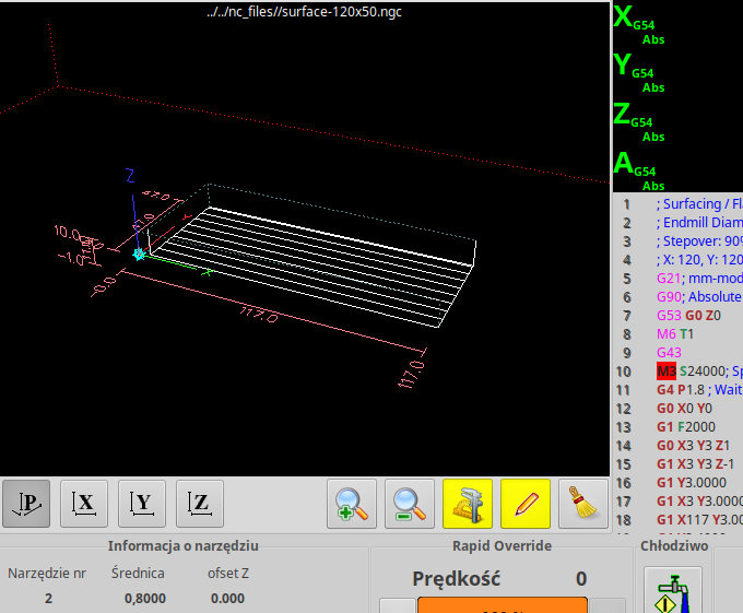

After switch to "P-view" again :
I have got touch screen, and its hard to change view without mouse.

After run program :

My oversight - I didn't look at the section - only the title.
Is your question pertain to the default zoom of the perspective?
As your first image and second look the same.
