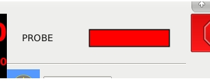

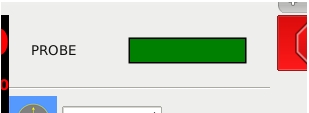

As I mentioned in my previous post, of course it is possible.
Hereby the two photos of the "led" with not activated and activated probe.
You report in the ini-file in which hal-file you will place the connection.
By me is it "paneel.hal" and in it the line "net probe-in => paneel1.probe" because in Glade I named the rectangle "probe".
