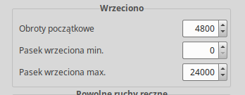

I need ~500 rpm for edge finder, but the spindle bar is not in rpms but in percents, and 10% is minimum value.
In my spindle maximum rpm is 24000 and 10% is 2400.
I have broken my edge finder when I was try use it at 2400 rpm.
I know, I can set rpm in MDI, but what is spindle bar for, if it is unusable for this?
Where can I change minimum spindle bar value?

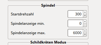

The label S 300 is the actual spindle speed of 300 rpm
the button 100 % resets spindle override to 100 %
The Bar in % indicates the spindle override, so going from 100% to 50 % will reduce Spindle speed to 150 rpm
The three button will turn counterclockwise, stop clockwise the spindle (from left to right)
The lower bar ist the spindle feedback bar and will indicate the feedback from the spindle encoder.
If no S value is set (see S value in G-Code Info frame) the spindle will turn with the rpm value you have set on the settings page Tab hardware:
First entry = the start rpm if no S value is set
Second = the min possible spindle rpm (just to set the spindle feedbar bar limit)
Third = the max possible spindle rpm (just to set the spindle feedbar bar limit)
In case of such questions, it might help also to read the documentation. If you do not find a response to your question in that doku, please inform, as I try to maintain the docu as usefull as possible.

Now I found the solution, but I don't like it.
I have set MAX_SPINDLE_OVERRIDE = 5.0 in INI file and as below:
I get after GUI starts:
And minimum spindle speed as I need (10% of <start rpm> is 480):
And maksimum spindle speed as spindle allows:
Note that maximum spindle speed is not 100% but 500% overrided.
And last but not least, the 4800 rpm speed is rather unusable for me, in most cases I need <max> and <min>, not 100% of forced value 10*<min>.
Last edit: 16 May 2021 09:24 by tuxcnc.
