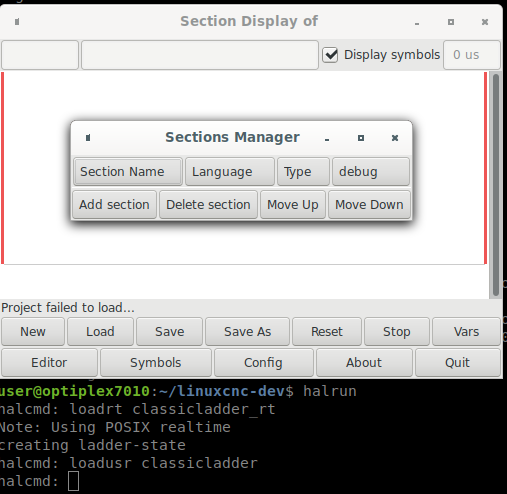

Classicladder not working was created by Aciera

are you loading it in the hal file?
- Posts: 4819
- Thank you received: 2177
02 Jun 2021 13:41 #211014

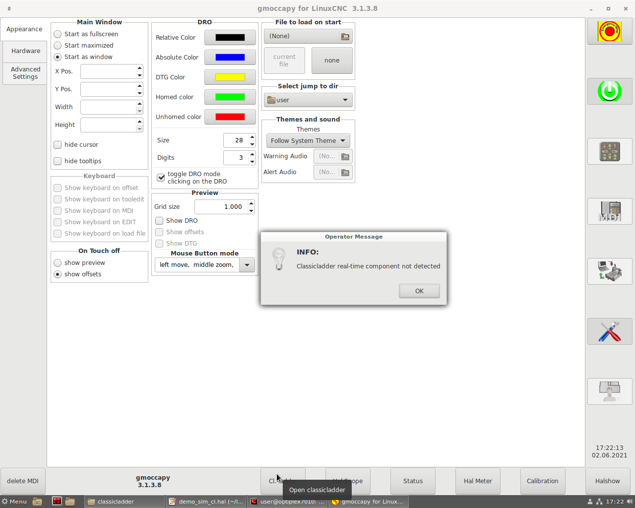

No, I'm trying to start it with the screen button in a gmoccapy sim config at the moment.
It works with older master builds but with the recent master it doesn't work any more. Something seems to have changed, maybe it's a python2 vs python3 issue.
Replied by Aciera on topic Classicladder not working

My appologies, looks like this button only works to load the classic ladder gui if classicladder was loaded in HAL.
Thanks for your attention anyway.
