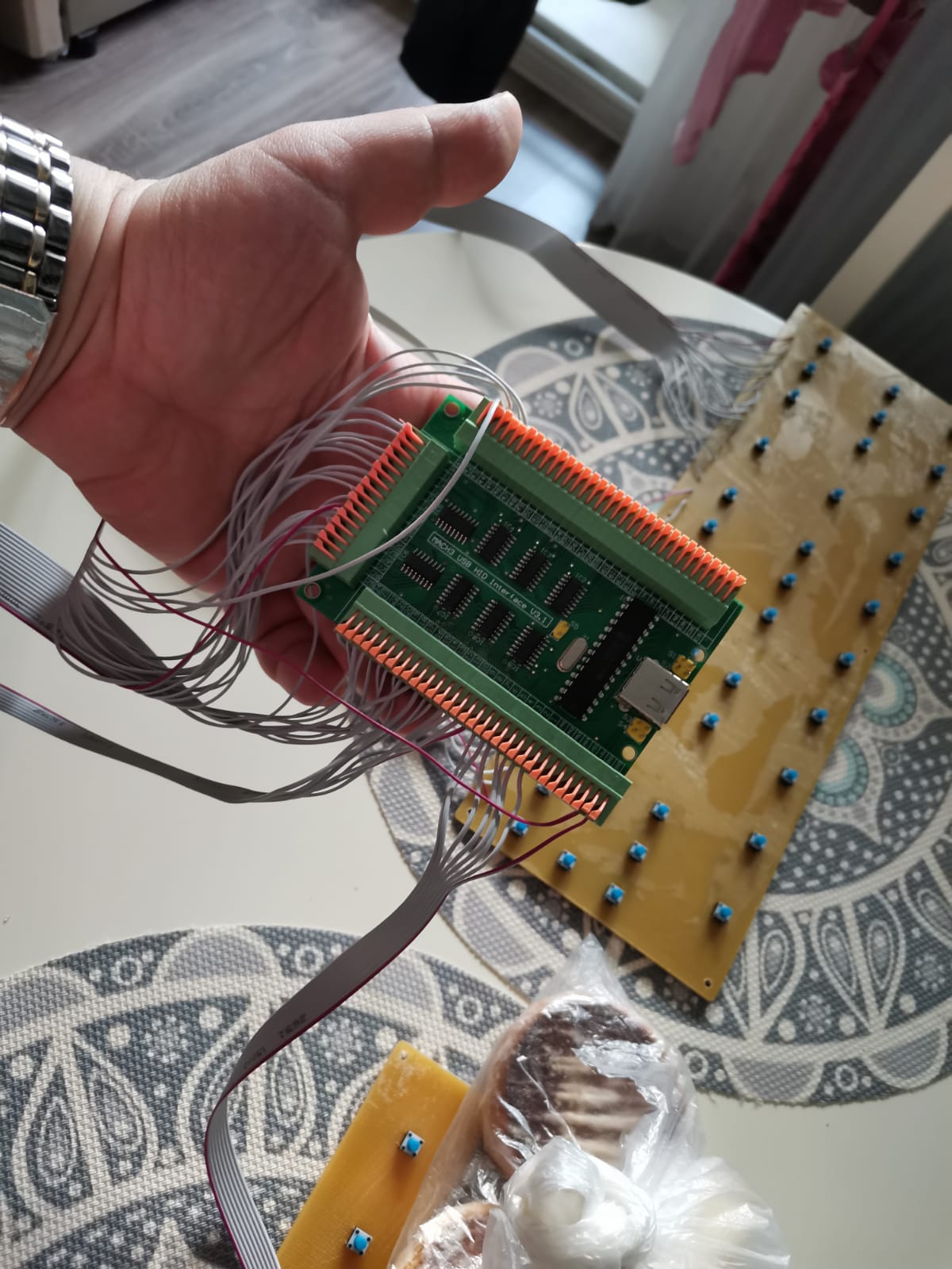

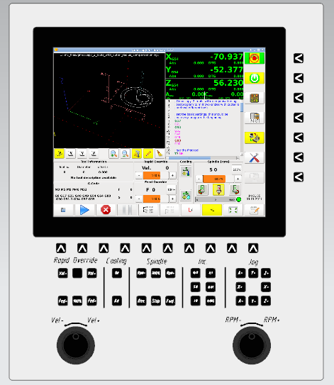

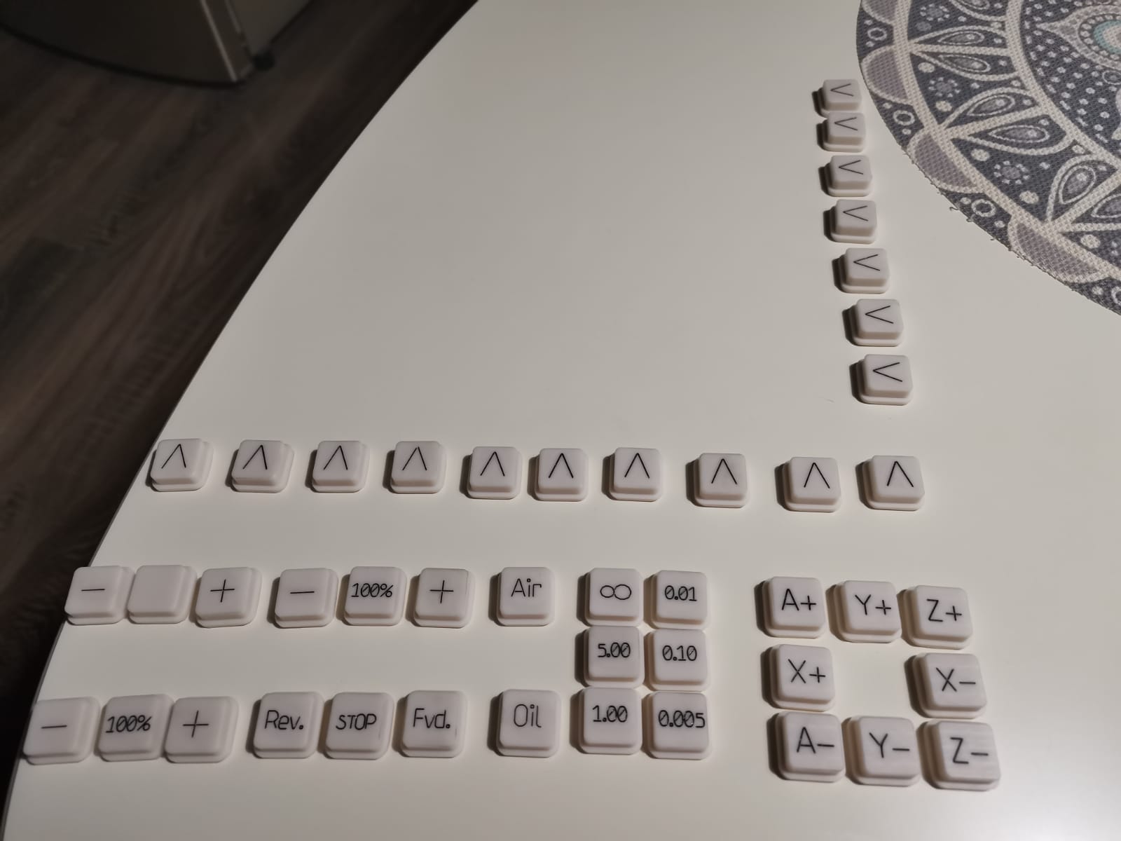

Hello dear users of LinuxCNC system and Gmoccapy interface. I want to share with you my idea to make an external control panel for this interface. This is how I see the design of this project. I have not yet worked out the design in detail. This is just a design for now. I would like to hear your opinion and tips on how this can be done better. I am more interested in the question of how to associate physical buttons with the GUI. I would like to do without using free GPIOs on MESA boards. I have an idea to use a Gamepad controller and a Joystick system component

Yes, I read this section. The fact that gmoccapy already has program contacts I understand. It is not very clear to me how to connect a physical panel at the hal level, which most likely should be an HID device with gmoccapy soft contacts. If you know how you can access the elements of HID devices, tell me how to do it. I'll be very thankful. Best regards, Simutin Anton

I would just accept using Mesa GPIOs. Probably using a 7i73 to provide them.
It could sit in the control panel and also handle the MPG interfacing.
(consider matrix-wiring the buttons if there is not enough single-pin GPIO. )

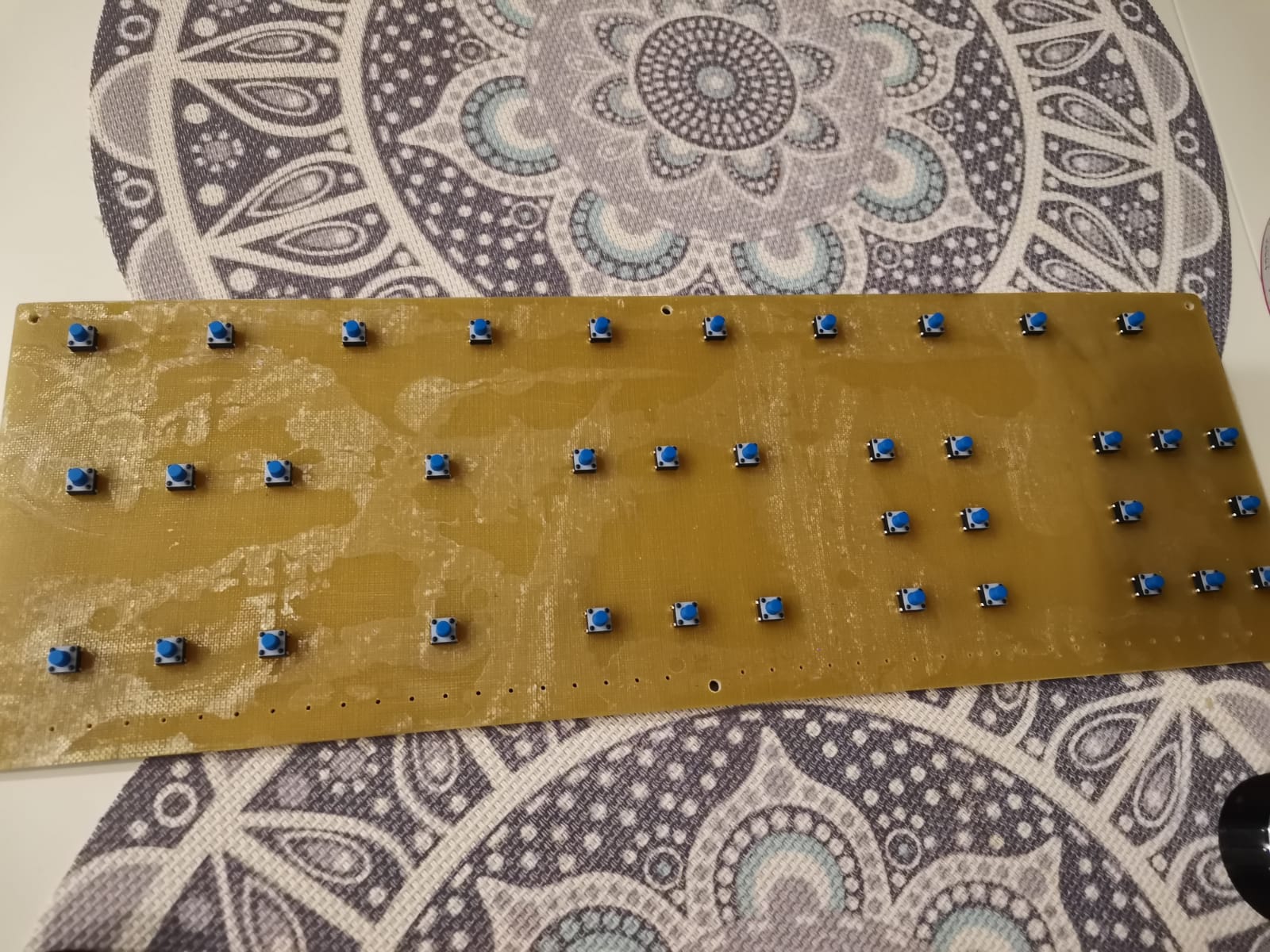

I found a USB HID controller option for myself, which has a sufficient number of input signals. Already tested this device, everything works. For work, I used the hal_input component.
Вот вариант решения
Slowly making control panel components
Вот вариант решения

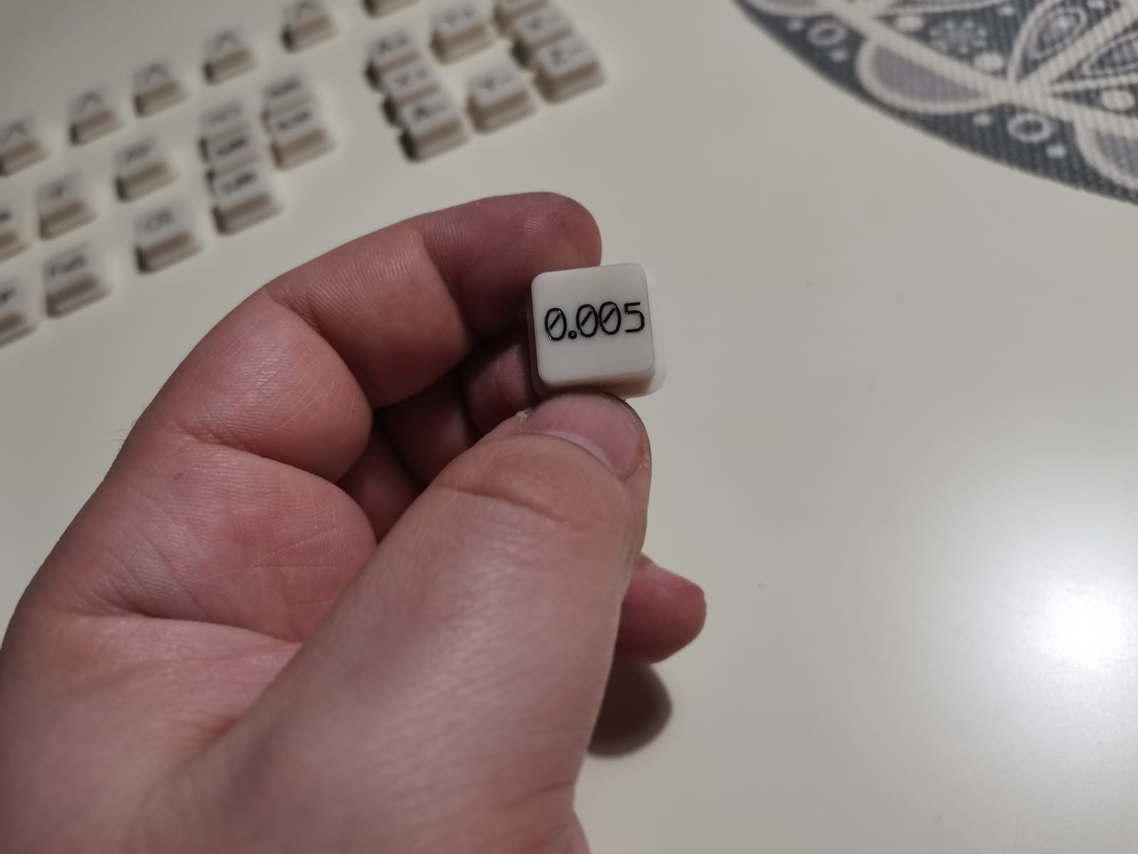

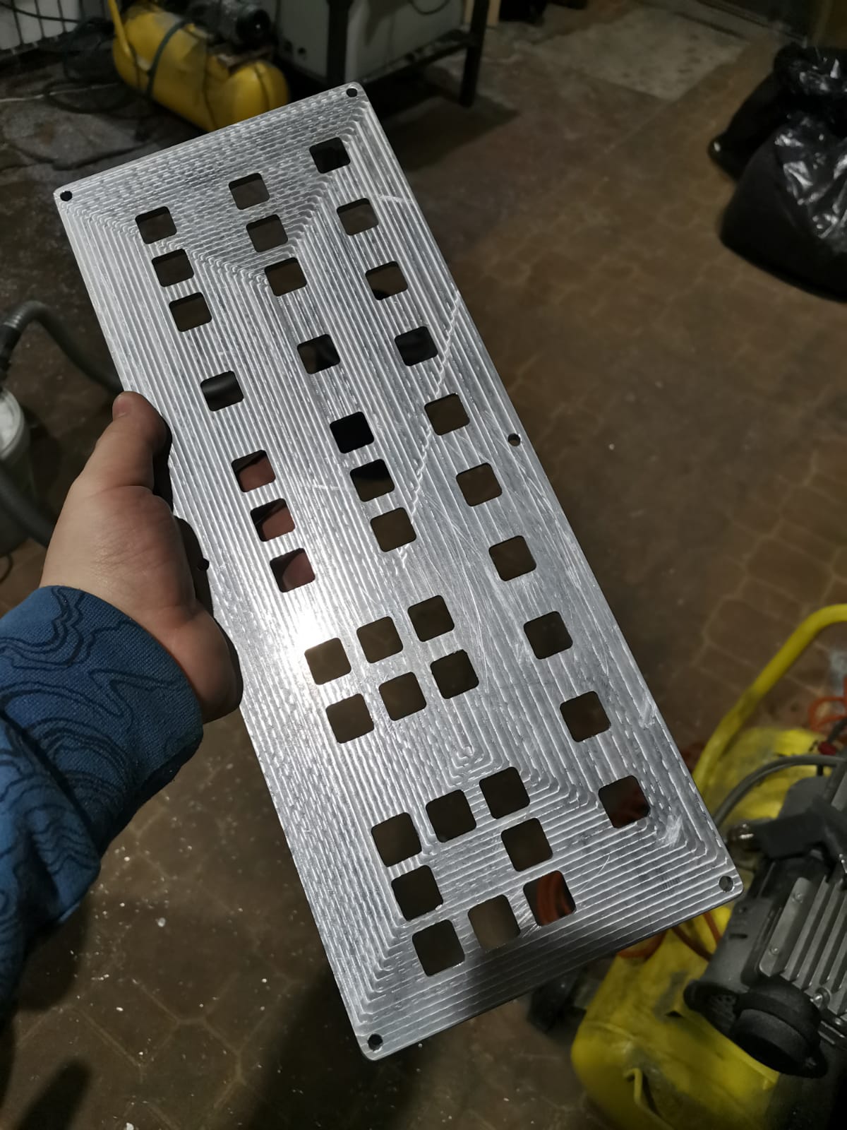

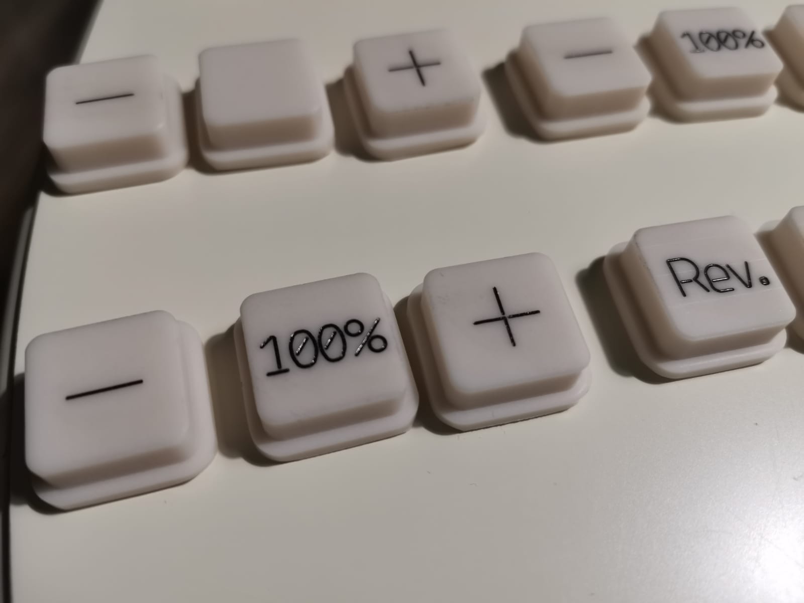

Very neat design you have.
What keycaps are you using and how are you doing the symbols / lettering, laser engraving?

Fantastic job you are making on that. Are you also using matrix keyboard functions in LinuxCNC? I liked that the Maesa 7i73 supports that as well.
