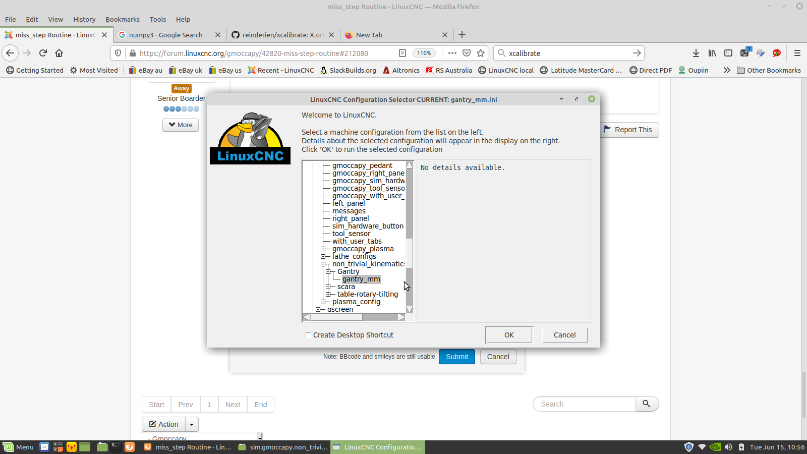

I think you need to look at joints. Do you have a line such as
This was take from a configs/sim.gmoccapy.non_trivial_kinematics.Gantry
# loop position commands back to motion module feedback
net Xpos joint.0.motor-pos-cmd => joint.0.motor-pos-fb
net Ypos joint.1.motor-pos-cmd => joint.1.motor-pos-fb
net Y2pos joint.2.motor-pos-cmd => joint.2.motor-pos-fb
net Zpos joint.3.motor-pos-cmd => joint.3.motor-pos-fbThis was take from a configs/sim.gmoccapy.non_trivial_kinematics.Gantry
