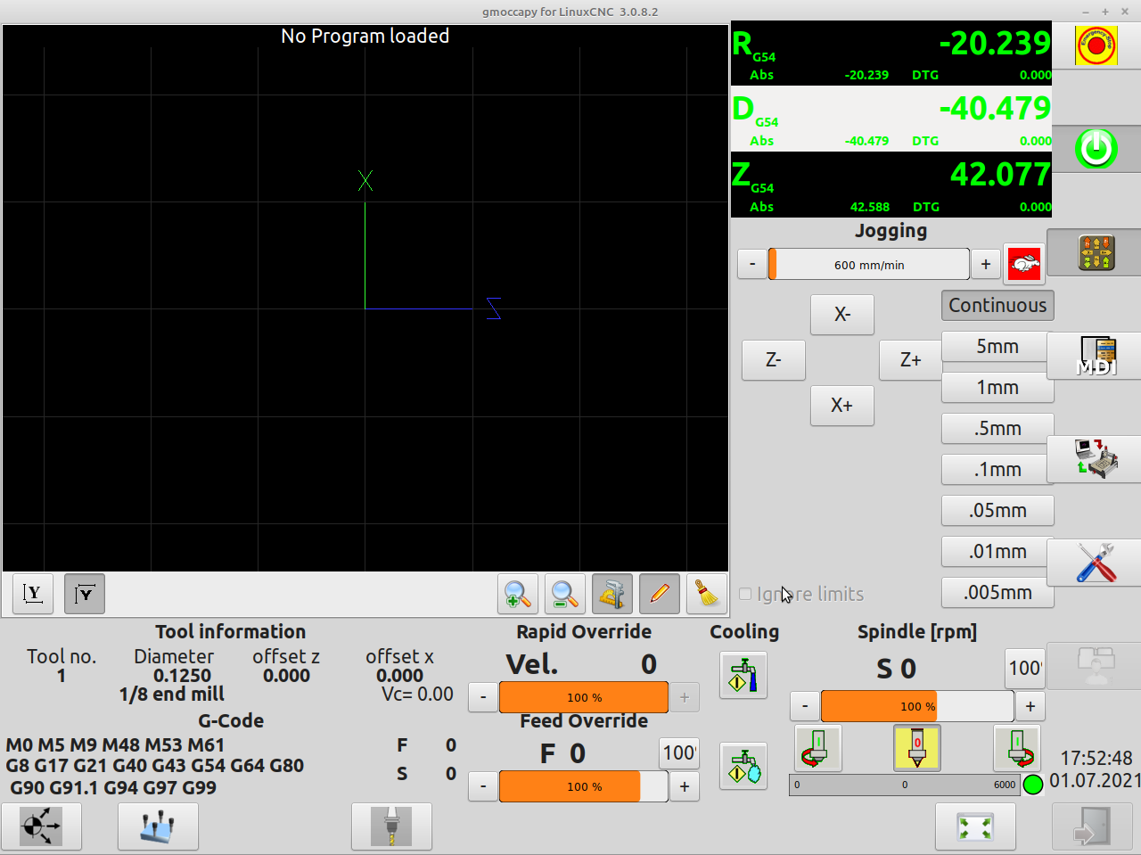

That looks very strange. Have you changed the font size in your desktop environment? Or have you done any changes to the desktop theme?
Can you try to change theme "Settings page" to be Clearlooks ?

The font looked tiny at recommended resolution so i increased the font size.
I will have a look at it in clearlooks tomorrow.

If you do not reduce the font size you will not get any difference

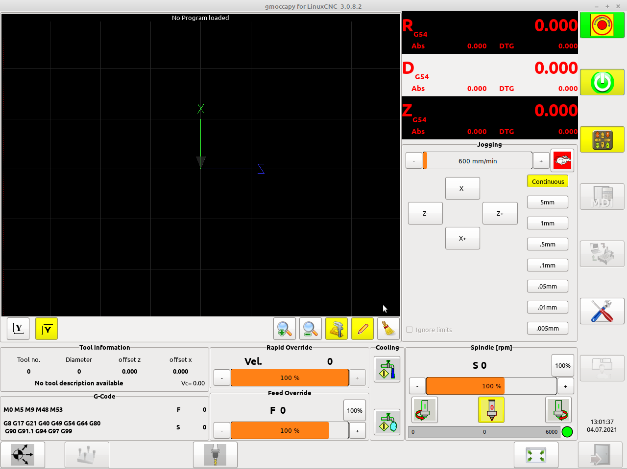

Looks OK for me.

Reducing the preview size will not enlarge the button.
Better reduce the screen size. Can you try 1024x 768?
Gmoccapy needs at least 979 x 750 Pixel
Norbert
Norbert

Tried that ! Could not get it to fit the screen. Bottom and right not accessible to me
Best resolution for me is 1024/768 with a font size of 14.
At that though I lose the facility for the pop up menu bar .
It is still there on the desktop but can only get to it by opening the exit door which closes the program.

You may want to move the menu bar to the left side, instead of having it on the bottom of the screen.
How to do that depends on you desktop manager.
Norbert
