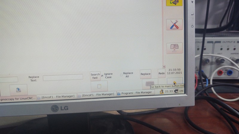

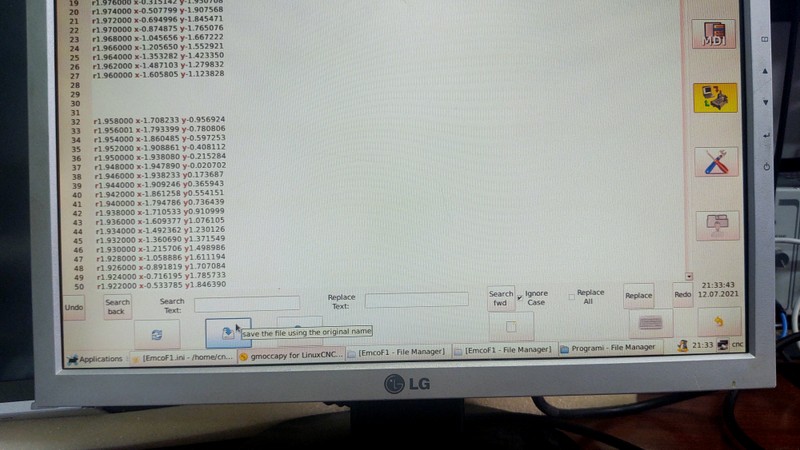

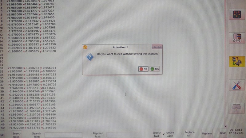

Hello, i just now installed LinuxCNC 2.8.2 on debian 10, and using Gmoppacy. In Auto mode, edited the NGC program, and saved it with button: "Save the file using the original name", after clicked on button: "Go back to main button list". After i get Attantion window: "Do you want to exit without saving the changes?"I checked, tha changes is saved in the NGC file, but then why we get Attantion window?I think it is a little bug.

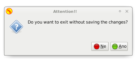

I have the same problem.

Have you moved the cursor after saving?
Any move of the cursor in the edit window is treated as a change.
This is caused by the widget itself, gmoccapy just reacts to the signal.

I tried to save the file and not move around the text area, but it didn't help.
