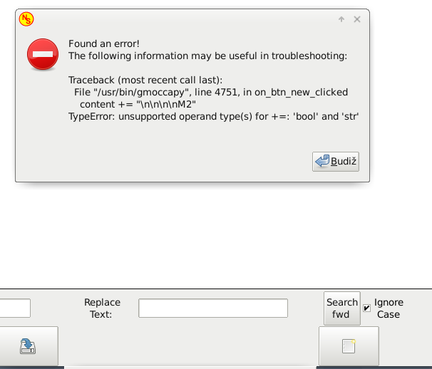

I have LinuxCNC 2.8.2. If I click on "new file" button, it dont work.
Python is not my friend. Could you help me?
# make a new file
def on_btn_new_clicked(self, widget, data=None):
tempfilename = os.path.join(_TEMPDIR, "temp.ngc")
content = self.get_ini_info.get_RS274_start_code()
if content == None:
content = " "
content += "\n\n\n\nM2"
gcodefile = open(tempfilename, "w")
gcodefile.write(content)
gcodefile.close()
if self.widgets.lbl_program.get_label() == tempfilename:
self.widgets.hal_action_reload.emit("activate")
else:
self.widgets.hal_action_open.load_file(tempfilename)
# self.command.program_open(tempfilename)
self.widgets.gcode_view.grab_focus()
self.widgets.btn_save.set_sensitive(False)
def on_tbtn_optional_blocks_toggled(self, widget, data=None):
opt_blocks = widget.get_active()
self.command.set_block_delete(opt_blocks)
self.prefs.putpref("blockdel", opt_blocks)

Do you have an RS274 start code in your INI File?
If not try to add any code, i.e. G54 and report back.
Norbert

Replied by HalaszAttila on topic new file button - dont work
Hello,
i tested with a RS274_STARTUP_CODE = G54, and it solve the problem. Thanks.

I added RS274_STARTUP_CODE = G54 and this not helped me.

RS274_STARTUP_CODE = G54 - it is probably wrong
RS274NGC_STARTUP_CODE = G54 - it should be better
I'll try and let you know.
linuxcnc.org/docs/2.5/html/config/ini_co...sub:RS274NGC-section

[RS274NGC]
RS274NGC_STARTUP_CODE = G90
It solved my problem.Thank you for help.
