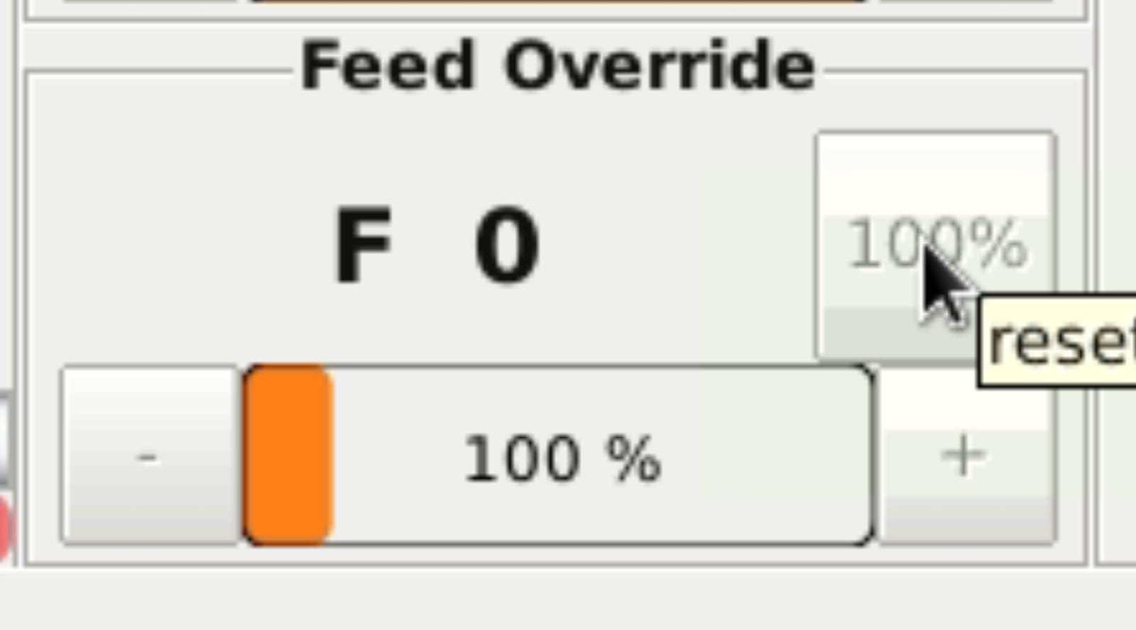

Hello,
I'm trying to make some customization at gmocappy display.
I added another "Speedcontrol" widget from gladevcp and I would like to introduce a "100%" button like in the feed override.
The problem is that from hal I can't see parameters or pin to change the value directly to a preferred one.
Owner Type Dir Value Name
53 bit IN FALSE GUI.decrease
53 bit IN FALSE GUI.increase
53 float IN 100 GUI.scale
53 float OUT 1 GUI.scaled-value
53 float OUT 100 GUI.value
What can be a possible solution?

Replied by cmorley on topic SpeedControl widget 100%
Unfortunately it can only be changed directly with python code.
I don't think GMoccapy exposes away for users to add python code.
Hopefully Norbert will have advice for you.

Replied by AlessandroT on topic SpeedControl widget 100% [solved]
I solved, with the following code, where "btn_feed_100" is a GtkButton widget and "extr_scale" is a SpeedControl widget. Thanks
#!/usr/bin/env python
import linuxcnc
import os
import hal
import hal_glib
class HandlerClass:
def on_btn_feed_100_clicked(self,data=None):
self.extr_scale.set_value(float(100)) # set the widget value to 100
self.extr_scale.queue_draw() # force a widget redraw
def __init__(self, halcomp,builder,useropts):
self.builder = builder
# hal pin with change callback.
# When the pin's value changes the callback is executed.
self.extr_scale = self.builder.get_object('extr_scale')
self.btn_feed_100 = self.builder.get_object('btn_feed_100')
def get_handlers(halcomp,builder,useropts):
return [HandlerClass(halcomp,builder,useropts)]
