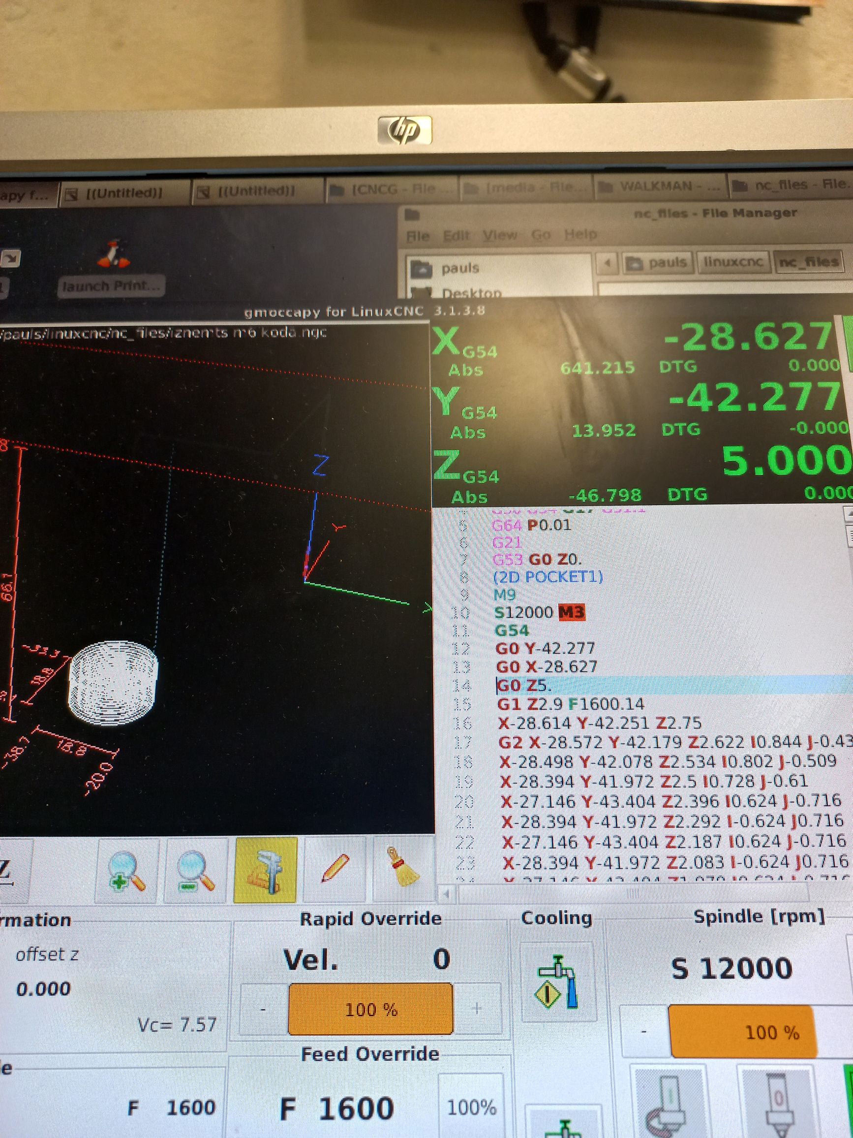

Hello. Could someone help me sorting this problem out.
I installed touchplate on gmoccapy and gcodes wont run, spindle stops right at model starting point.
I cant run gcode without using touchplate option as well.
This gcode worked before. Every other gcode stops at the same location (cutting starting point).
I have no errors at starting/running work/gmoccapy.
I can run this code in MDI
I use fusion 360 for modelling and linuxcnc post processor.

Without the config folder and the gcode, nobody will be able to help.
What if you go back to the config without the touchplate, or have you tried to run the code in a Sim config?
Most probably this is not related to gmoccapy!
