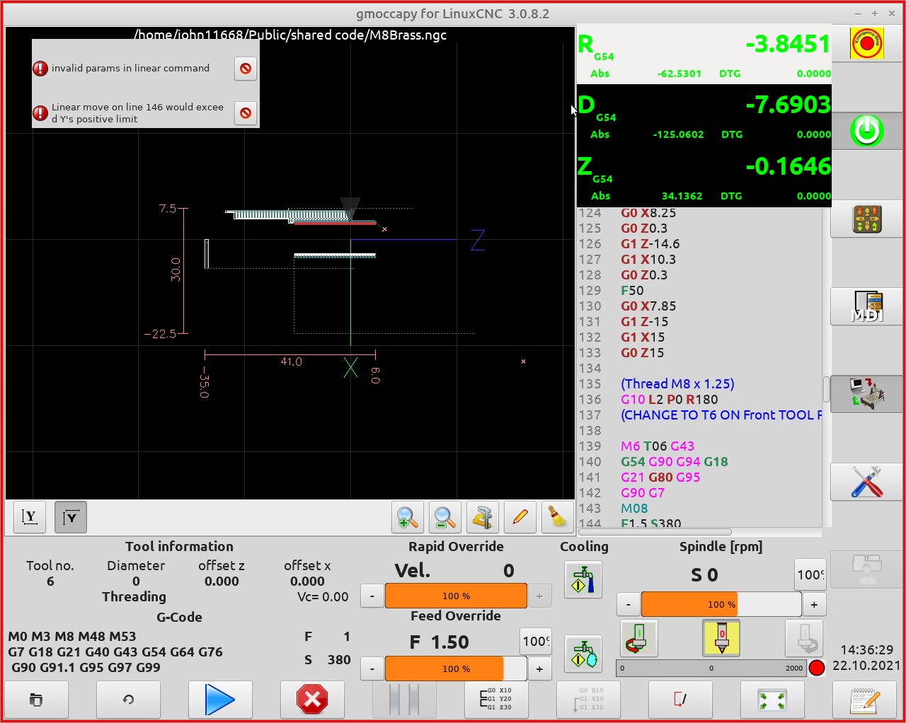

I have also done this earlier this week. Have you tried this with tool radius compensation as well? G41/42? Had some challenges with that and R180....
21 Oct 2021 07:29 #223788 by Aciera
Replied by Aciera on topic Back or front tool
I missed this:
Right so called up G10 L2 P06 R180 and it tells me " invalid parameters in linear command"
And "linear move on line 13 would exceed Y's positive limit " And I dont have a Y axis ???????
I believe for that you need to set up a dummy Y axis in the INI file. So maybe you can give that a try before we start going down the kinematics path.

21 Oct 2021 18:38 #223832 by john11668
Replied by john11668 on topic Back or front tool
I did try to set up a Y axis because software was looking for it .
I copied X axis with similar limits , but could not open Gmocappy after that without error report .
Clearly my Ini Y axis was not acceptable
any pointers would be appreciated .
X and Z were originally set up using Stepconfig.
22 Oct 2021 07:19 - 22 Oct 2021 07:20 #223885 by Aciera
Could you post your hal and ini files?
[edit]
Also please post the error report.

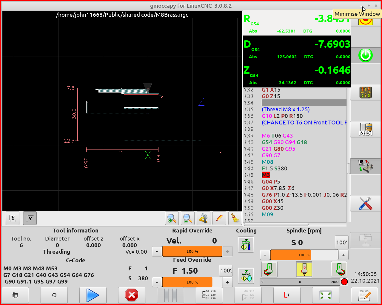

22 Oct 2021 13:43 #223921 by john11668
Right
So I seem to have managed to create a dummy y axis
Included the rotate command before the threading tool change and  clearly  the threading cut has gone to a front tool position on the screenshot  but restarting at line 134 bring up the errors shown
Clearly I need to do something to overcome this Y axis error.  Does this axis somehow need to be included in the homing process  and if so how?
Will post ini and hal seperately
22 Oct 2021 13:52 #223922 by john11668
sorry  - screenshot with line 146
