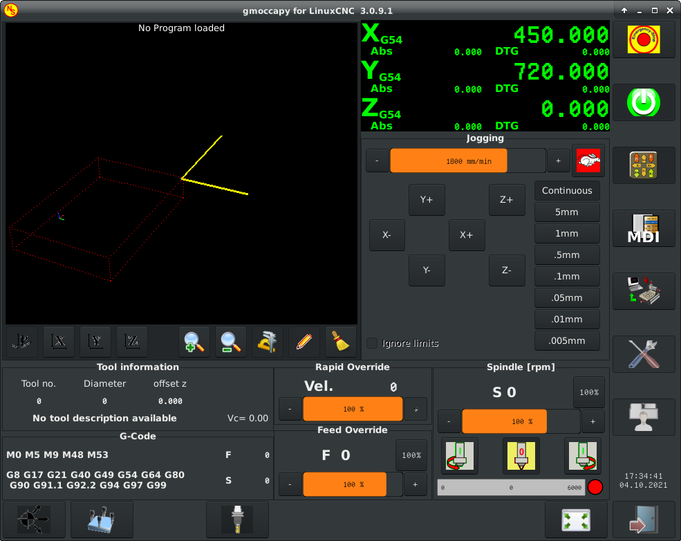

I can't press the setting button.
I'm not sure why, but it's probably because I played with INI files.
Please help someone.

Most probably you have selected to control the settings page through the corresponding gmoccapy hal pin.
You can change the behavior by hand editing the preference file or setting the Hal pin by hand to get access to the settings page.
You will find all necessary informations in the documentation of gmoccapy.

OK,
I haven't solved it, but I'll try to find the item in the documentation.
For the time being, you should edit somewhere in .hal.

Try to delete the preference file prior to start the GUI, that should solve the limitations.
Look for Hal connections to gmoccapy settings button in hal.
