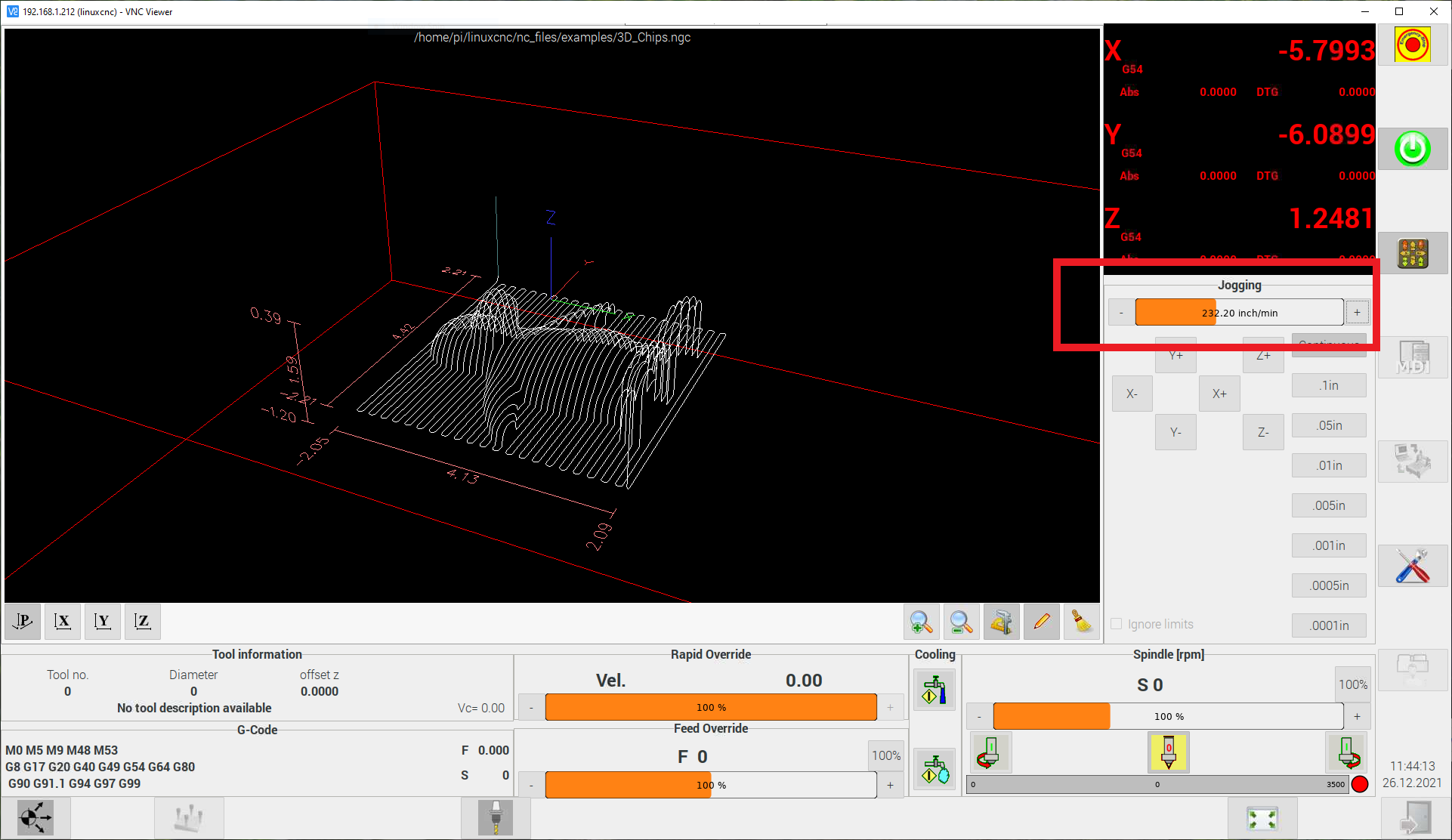

How does one edit the max MDI jog speed? My machine moves at 100 IPM max but the MDI jog interface goes up to 600 IPM. When set to anything above 100, the machine stays at 100 as expected, just wan to tweak the UI to match the machine limits.
Thanks.

What gui? Share your ini file. Often the values are taken from there for different gui features.

I have attached the ini file and screenshot of the gui.

Can you also post your HAL file(s) and the .pref file?

See the attached files, I looked through them but it is not apparent where this setting resides at least to me. Thanks for the help.

BossSmooth.ini:88
It should bein the TRAJ section. I don't know why you commented the right line out
It should be
MAX_LINEAR_VELOCITY = 1.67

That was it, I am not sure how that happened. I was probably testing something out and forgot to comment it back in when done. The config for this machine has evolved over that last 6 years and I have a few more upgrades in mind to make the machine easier to use for me. I think the next upgrade will be a tool length setter. Thanks for the help, having a few more sets of eyes on things sure makes it easier.
