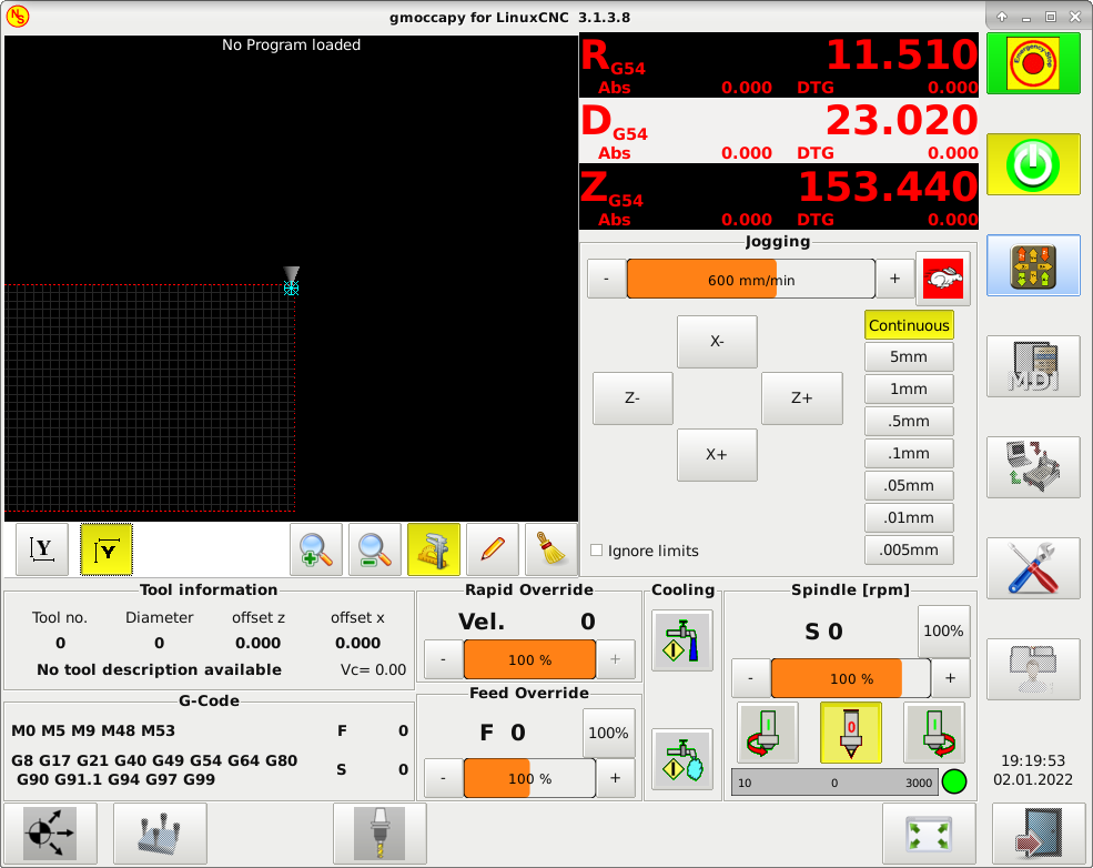

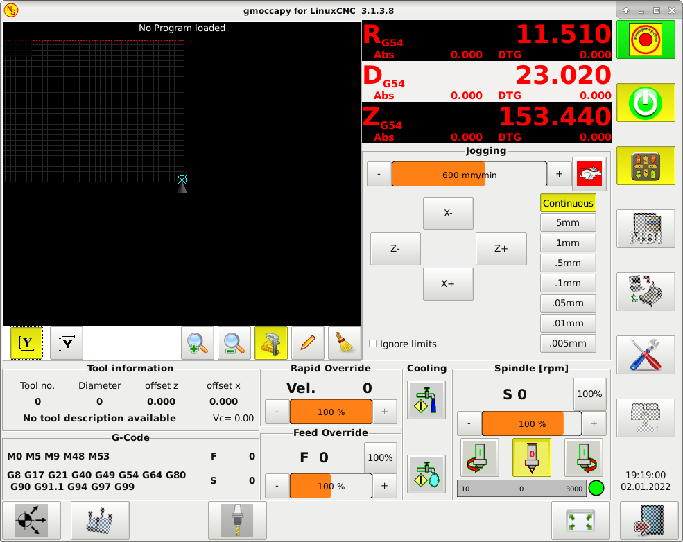

Hello,
If I want use Back tool X+ dont change to X -.
Here is X +- changed:
linuxcnc.org/docs/2.8/html/gui/gmoccapy....occapy:lathe-section
Is it bug or I use Gmoccapy bad?
I have newest version LCNC 2.8.2

Replied by newbynobi on topic Lathe backtool dont work.
The buttons will not change on the fly.
If you want to use a back tool lathe, you need to set your INI file accordingly.
- LATHE = 1
- BACK_TOOL_LATHE = 1
Norbert
