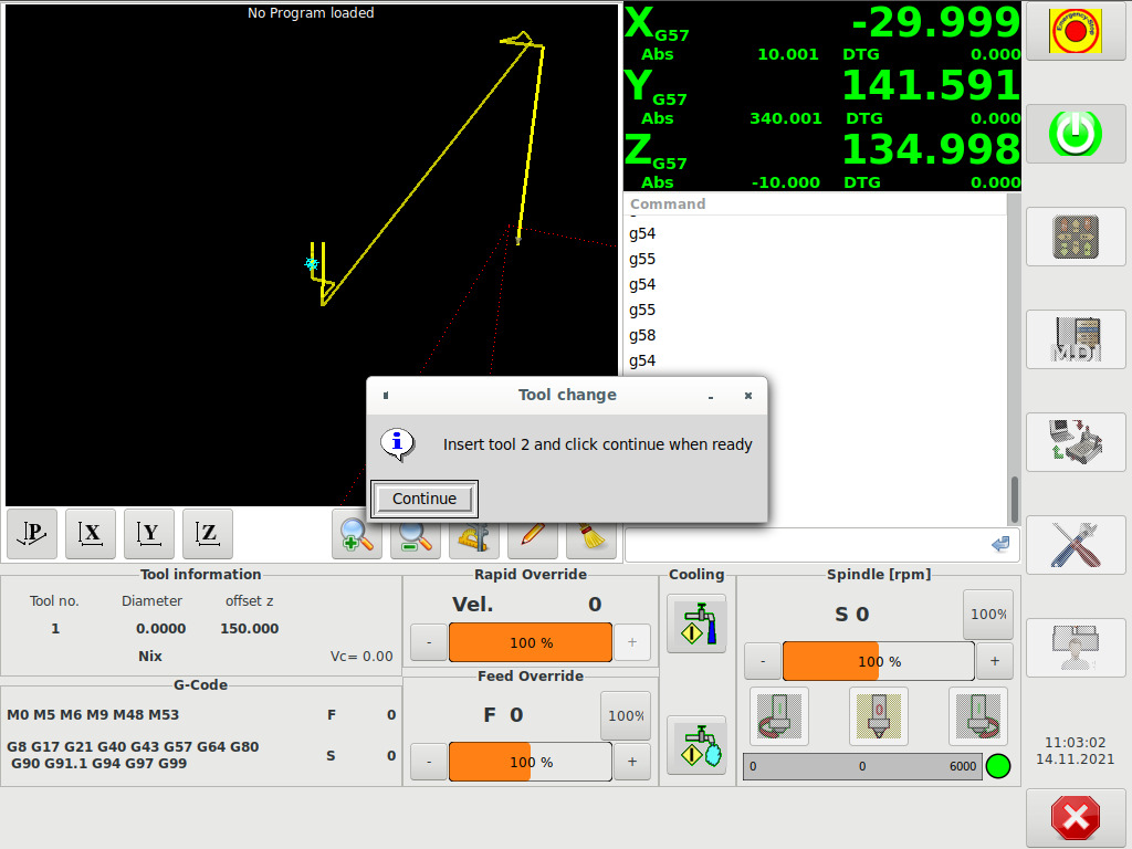

Tool change window was created by wedlocki

Replied by tommylight on topic Tool change window
I would say yes, it is also the same for Axis GUI, not sure for the other user interfaces.

Replied by cmorley on topic Tool change window
I bet you are using the hal_manualtoolchange component rather then Gmoccapy's built in one.
See:
linuxcnc.org/docs/devel/html/gui/gmoccap...ml#_tool_related_pin
