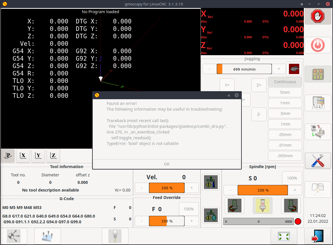

I get this error if I click the DRO panel, running 2.9 on mx19, I've also tried it on Buster 11 but it was the same.
Traceback (most recent call last): File "/usr/lib/python3/dist-packages/gladevcp/combi_dro.py", line 270, in _on_eventbox_clicked self.toggle_readout() TypeError: 'bool' object is not callableeinarak@linuxcncpc:~
$ uname -a
Linux linuxcncpc 4.19.0-18-rt-amd64 #1 SMP PREEMPT RT Debian 4.19.208-1 (2021-09-29) x86_64 GNU/Linux
$ python -V
Python 2.7.16
$ python3 --version
Python 3.7.3

The one mentioned above did not do it for me, but I got an update yesterday that did the trick. No more DRO errors for me. I almost pulled the trigger on a new pc assuming it was some hardware issue (runnin on a 11yo pc). But now I dont need to.
