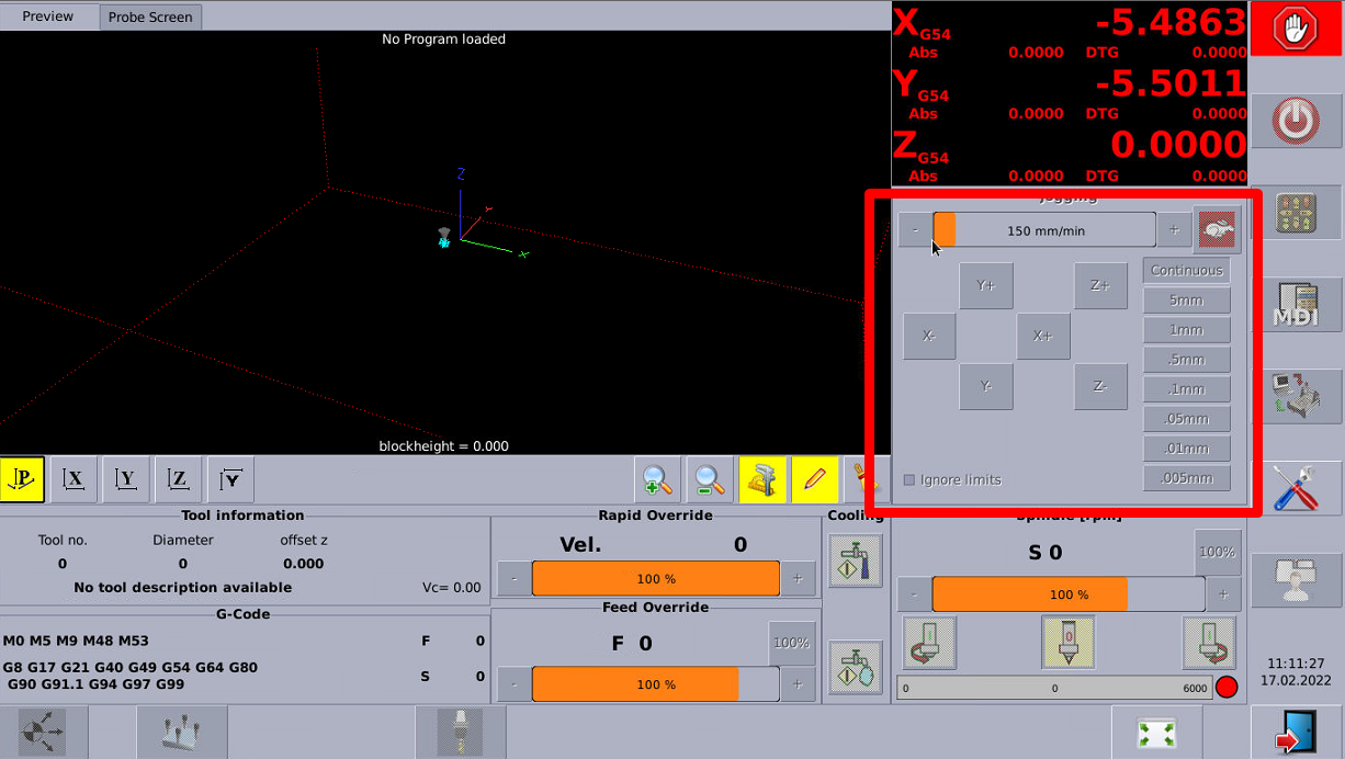

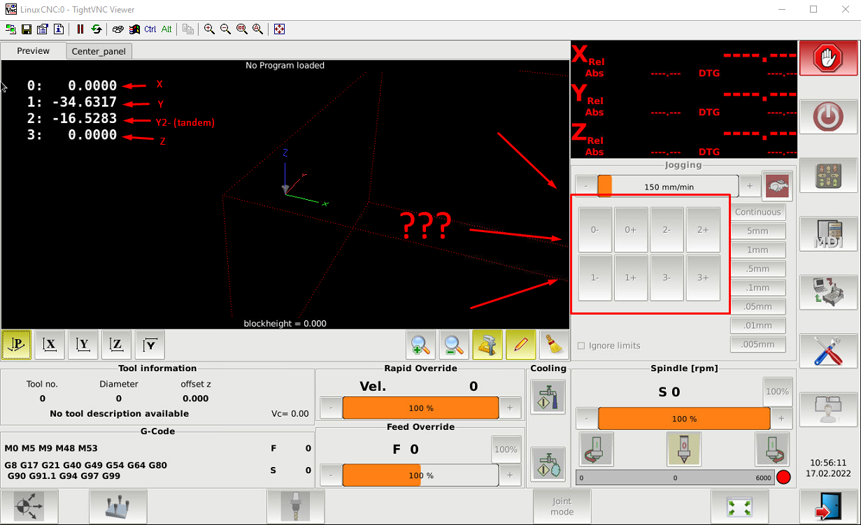

Good afternoon.
I installed a fresh build of LinuxCNC v2.8.2 (Debian 10 Buster PREEMPT-RT ISO), set it up as it was in the previous edition and found one unpleasant feature. In the new version of LinuCNC If there are tandem axes, the Jogging panel is not displayed correctly, it does not show the XYZ axes, but shows the numbers of the motors, while when controlling the motors that are in tandem mode, they go together, i.e. it turns out a couple of unnecessary buttons are displayed, and the display ceases to be convenient or intuitive.
How to fix it?
Here is an image of my LinuxCNC

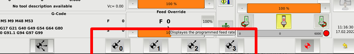

The search for the home position is also not displayed as before:
This is how it used to be:
How to fix it?

there are several possible reasons for the behavior:
- You do not use trivial kinematics
- Wong setup of your INI file, if you updated linuxcnc you might need to reconfigure some parts
- Your machine is not homed, after homing you should get back the axis jog button
First see documentation for more details, if you do not find the solution, post your config folder

I did not copy the files from the previous version, but configured using PNCCONFIG as exactly as the previous version, to check I did the same operations on the previous version and the result turned out to be different, in the previous version everything is fine, but on the new version as in the photo above.
The kinematics in the INI file is configured as follows:
[KINS]
JOINTS = 4
KINEMATICS = trivkins coordinates=XYYZ kinstype=BOTHPlease Log in or Create an account to join the conversation.

It looks like I fixed the problem, although I haven’t tried it on hardware yet.
The problem was in the line:kinstype needs to be changed like this:
Might be useful to someone....
KINEMATICS = trivkins coordinates=XYYZ kinstype=BOTHKINEMATICS = trivkins coordinates=XYYZ kinstype=1Might be useful to someone....
