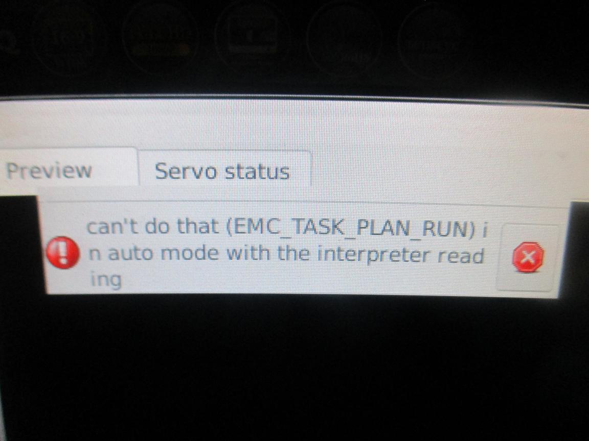

If I run program by pressing "R" shortcut linux give me error at picture, but if I run program by clicking at button "start" nothings happens.
If error pops up, nothing happens program runs correctly, parts is good, but its crazy for me becouse after 10 parts I have 10 pops up error messages

Which version of LinuxCNC are you running?
And does it happen with all G-Code files or only with a specific one?

The error means the machine is already in AUTO mode, so it is in pause or step by step/line by line mode.
If using Axis GUI, there are two buttons right side of the play/pause/stop/step buttons, one is for line by line mode i think, been a long time since i used that.

Yeah it occurs when trying to run the interpreter (AUTO_RUN) in INTERP_WAITING mode.
Actually this should be avoided by this statement:But the `stat` is only updated every 100 ms. Switching fast from pause to pressing "R" can trigger this. But I cannot reproduce this constantly. So I assume something with the G-Code file...
if (keyname == "R" or keyname == "r") and self.stat.interp_state == linuxcnc.INTERP_IDLE:
self.command.auto(linuxcnc.AUTO_RUN,0)Please Log in or Create an account to join the conversation.

In that case, it might have to do with "typematic rate settings" in computers BIOS, but it's been a long time since I've seen that. It was to set after how long of a key press it should start repeating.Switching fast from pause to pressing "R" can trigger this.

Im 100% sure that not depends on gcode. I run multiple different gcodes and always its happened.
But gcode is generated by CAM so maybe header of file that is always same can generate this error. I dont know. Always messeges popup at the start of program immediately I pres "R".
I send uname - a asap. I think Im using 2.8.2 Debian 10 Buster

What if you run one of the G-code examples of LinuxCNC?
If running this via start button doesn't work - then it is probably some wrong with your config or installation.
