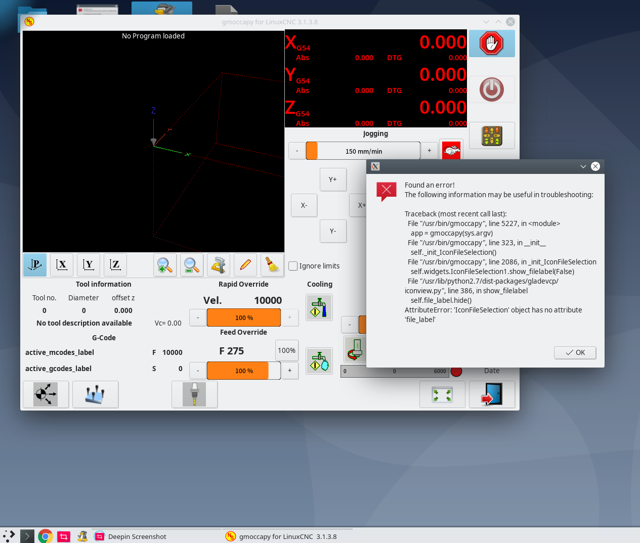

I get an error when I start Gmoccapy in KDE Desktop.
Is there a way around this?No problem with xfce
KDE gives good latency results in my environment. Switching to Xfce causes a fatal delay.
LinuxCNC 2.8.2 Debian 10 Buster PREEMPT-RT

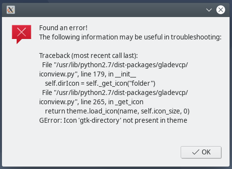

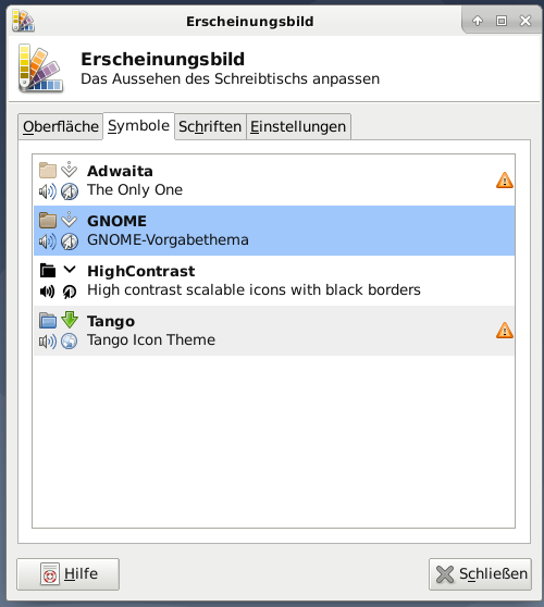

See the forum.linuxcnc.org/gmoccapy/33045-error-...capy?start=20#237136
So try to install and enable another icon theme.
On my machine Gmoccapy only works with the icon themes GNOME and Tango.

Thanks to you,
I was able to safely avoid the error by installing gnome-icon-theme.
