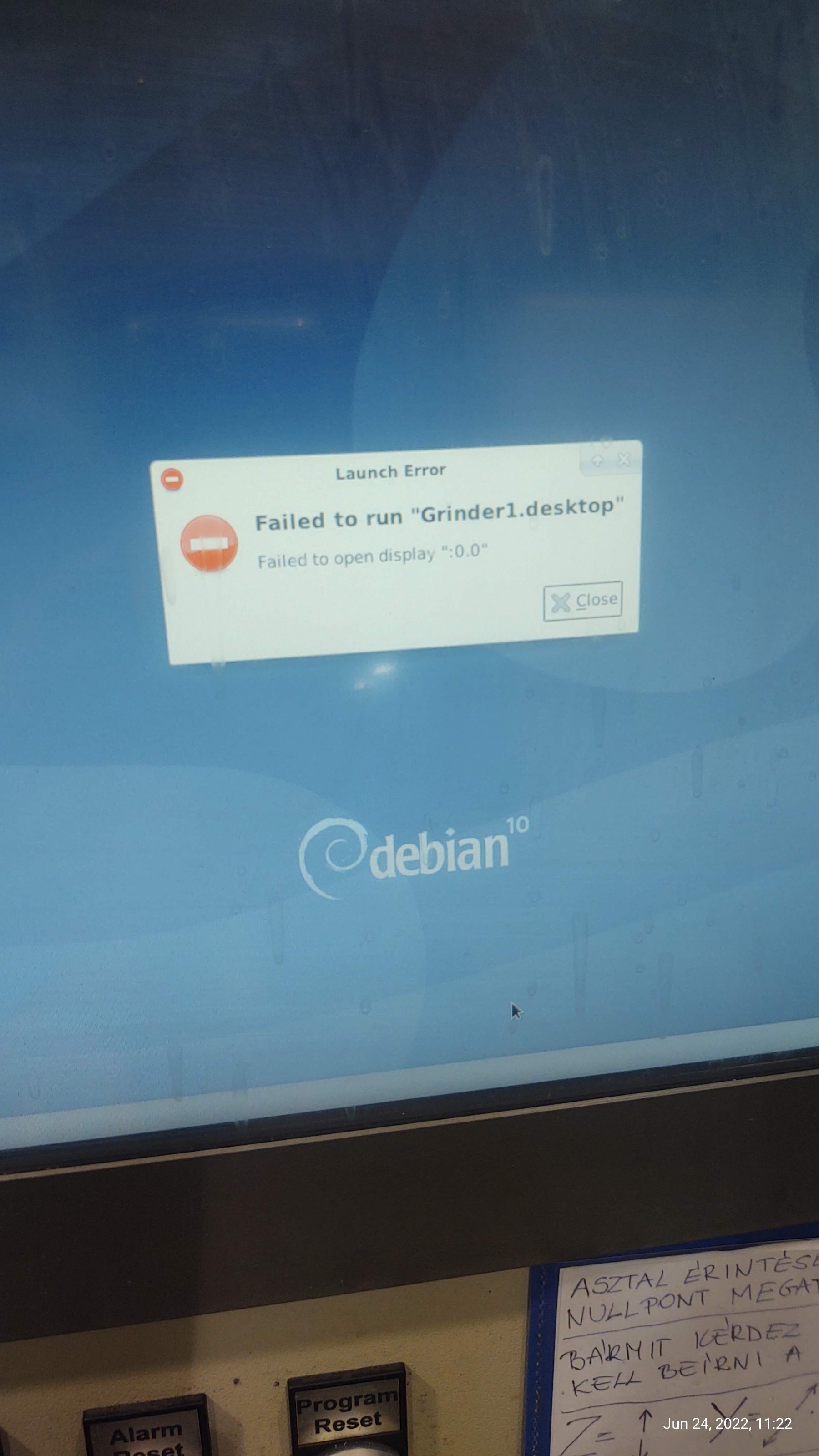

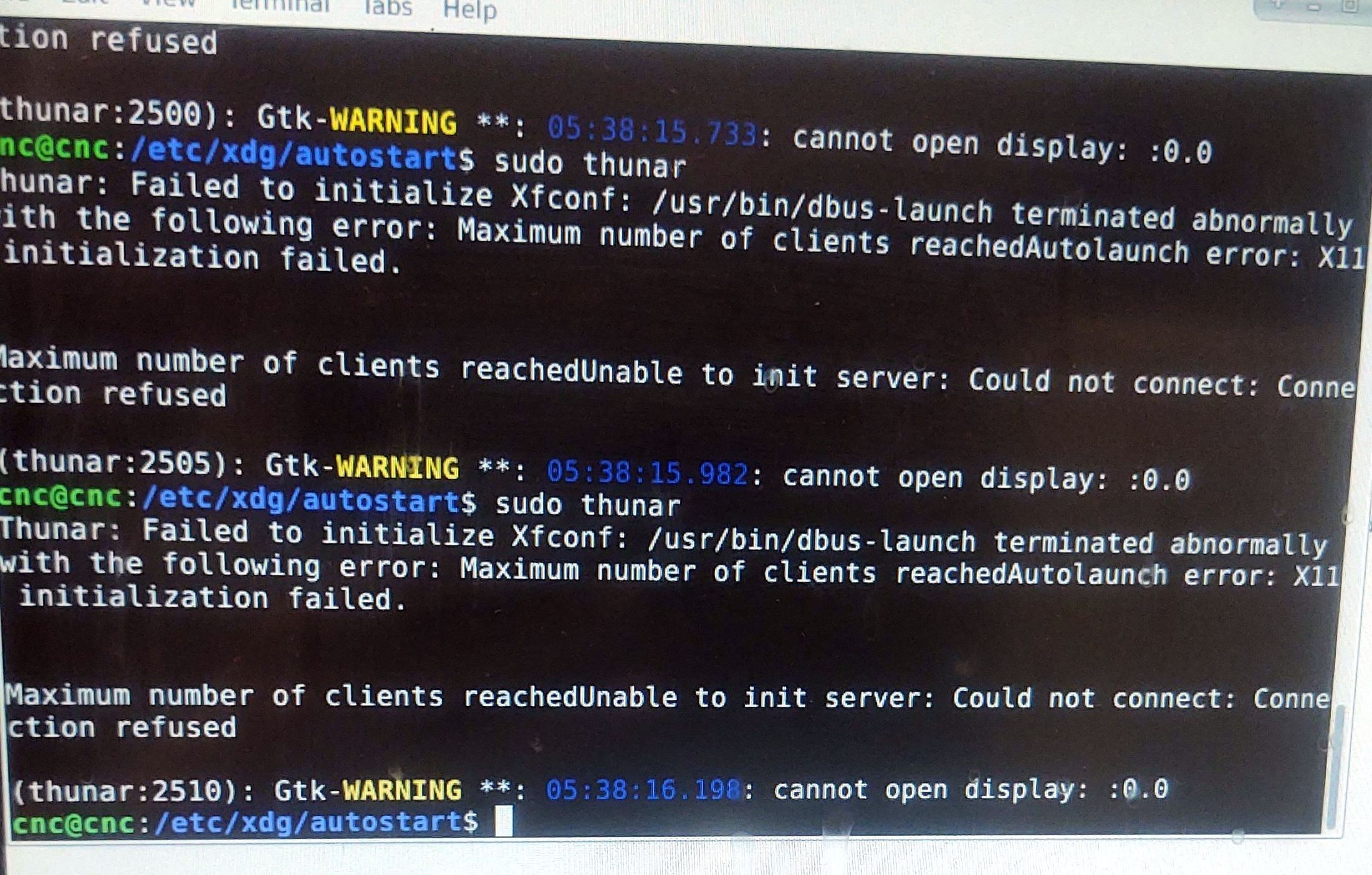

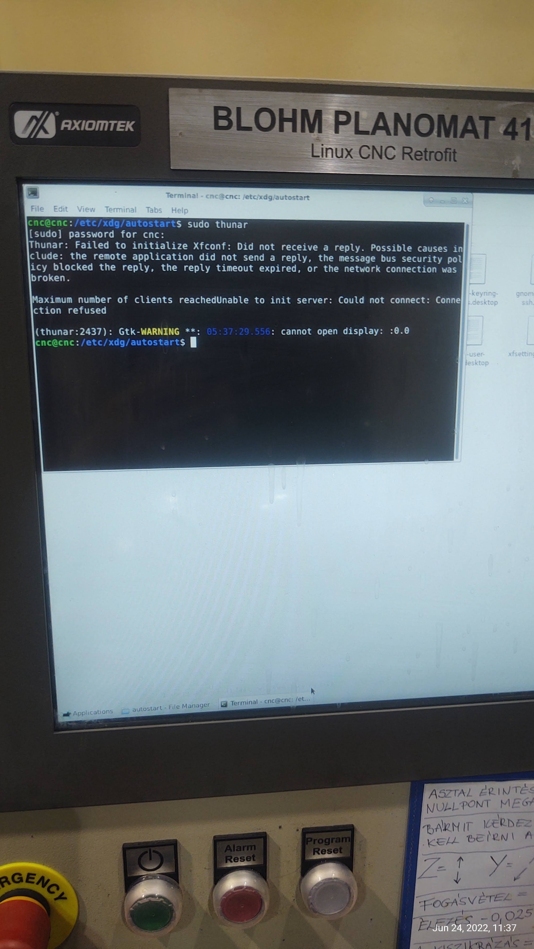

Today i found some confused thing. Debian 10 + LinuxCNC 2.8.2.
I use custom panels and ngcgui panel in Gmoccapy.
Somehow, i dont know how, but I do that Nm-tray Network Manager on every statup increase the running tasks.
I see it on tray. On every startup one more little computer what shows network communication.
After using the machine few months, maybe there are about 100 running Nm-tray task in the background.
And today starts doing problems. On the begenning, just custom panel and ngcgui not loaded on LinuxCNC startup, after few restarts,
the linuxcnc gui wont starts, and get this message. I dont know what this means, but something connected to display.
I try to open Thunar, and it doesn't starts either.
When u uninstalled the Nm-tray, the LinuxCNC starts without problem and shows custom and ngcgui panels too.
***Grinder is the name of config folder and HAL / INI files.

The solution to the multiplying nm-tray icons is here:
forum.linuxcnc.org/38-general-linuxcnc-q...ssues?start=0#226480
Though I think that you can just right-click them one-by-one and then unselect the app in settings.
The other problem is strange. Are you sure that you are not in an ssh session to a remote PC?
