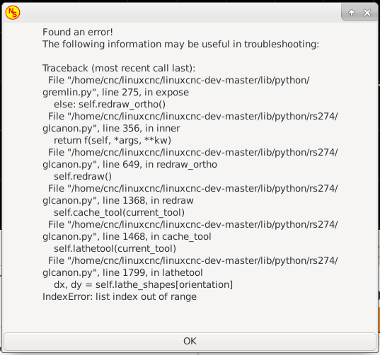

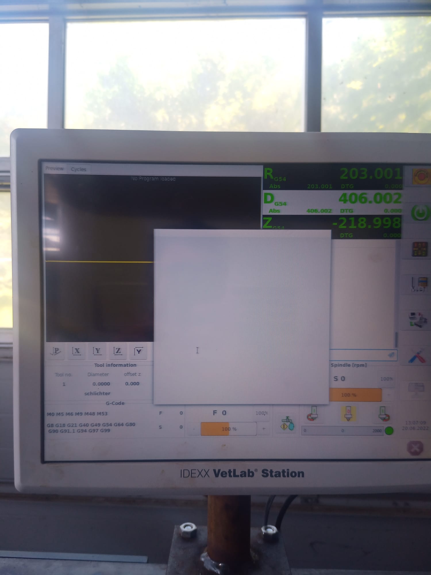

Not sure if it has to do with Gmoccapy or with Linuxcnc itself, or what I have configured wrong.
I wanted to write a small test program today to try out the radius compensation (g42).
Whenever I call a tool where a radius is defined in the table, a window comes into the foreground, cannot be clicked away and also the complete gmoccapy window does not react anymore.
System is linuxcnc 2.8.2

I have found the error.
It was neither gmoccapy nor linuxcnc. It was the user,
I have set the tool orientation in the tool table as a degree number like front and back. The correct position would of course be set as integer 0-9 according to the manual.
In my case a 2.
Corrected and the machine ran
In my case a 2.

if you want to reproduce the error
this is the entry in the tool table
T1 P1 X0.0 Y0.0 Z10.0 A0.0 B0.0 C0.0 U0.0 V0.0 W0.0 D9.9 I30.0 J87.0 Q50.0 ;schlichter
and this would be my quickly written program
g21
g54
g61
g40
g7
g90
g90.1
g95
g18
g96 d500 s100
t1 m6
g43
g42
g0 x200 z10
g0 x160
s100 m3
g1 f1 z-20
g2 z-25 x170 r5
g40
g1 x200
m5
m30
Of course, it will run without problems if you enter a 2 in the tool table under Q.
