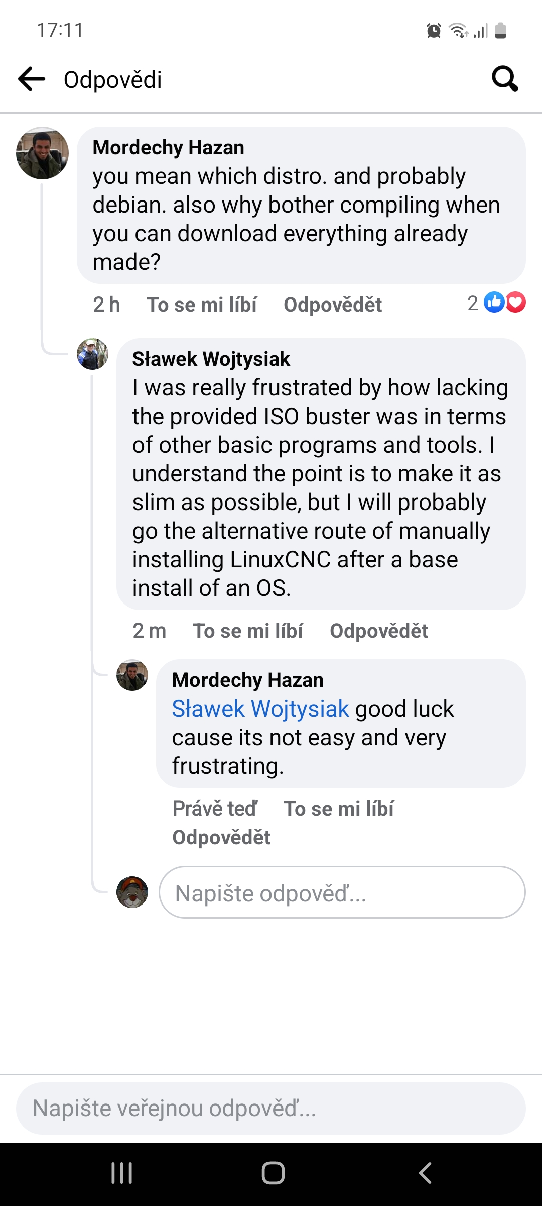

08 Jul 2022 13:55 #246862 by zz912
Replied by zz912 on topic Buidling LCNC 2.8.2 RIP - with Gmoccapy
but we have checked that the current list works on the buildbot platforms.
Your check have bug, or I do something that no one expects. (The second way is often :-) )
I made another RIP Instalation with normal Debian not RPI Debian
zdenek@CNC:~$ uname -a
Linux CNC 4.19.0-21-rt-amd64 #1 SMP PREEMPT RT Debian 4.19.249-2 (2022-06-30) x86_64 GNU/Linux
And I needed install the packages, which I mentioned at the beginning too.
I don't know if I need them all, but I'd rather have some extra packages than have LCNC not work for me.
I downloaded Live CD 2.8, and made bootable flash disk. I installed the flash disk. I "apt-get remove" all package with name *linuxcnc*. I installed RIP LCNC 2.8 linuxcnc.org/docs/stable/html/code/building-linuxcnc.html
Now LCNC 2.8 works. BUT only with AXIS or another GUI. Now LCNC 2.8 with Gmoccapy DONT works.
Then I install package which I mentioned at the beginning and LCNC 2.8 with Gmoccapy works.
It's not a problem for me. when i know this problem. But it might discourage someone who wants to start exploring the LCNC source code. What can I do to fix this error systemically?
I have another free PC where I can do some other test that would help you, but I need to know what would help you.
The easiest way is added the packages here:
OR?

08 Jul 2022 15:20 - 09 Jul 2022 20:35 #246868 by zz912
This is some discusion in Facebook.
For RIP 2.8 you must known this reporitories.
Last edit: 09 Jul 2022 20:35 by zz912.
