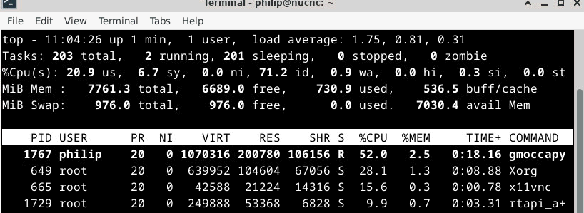

No, you're not alone. I realise this is a slightly old thread but it seems a fair match - happy to create a new one if required.
I have a very nice little 'industrial' Intel NUC i5-3427U 8GB RAM (ark.intel.com/content/www/us/en/ark/prod...-up-to-2-80-ghz.html) that runs very well - except for gmoccapy which averages 44% CPU and often goes over 50%.
In my original vanilla 2.8.4, with a MESA card, the CPU usage hovered around 40% causing the CPU to hit 90°C+ so I decided to install Debian 12 and LinuxCNC on a new hard drive (and WiFi card for reasons) in the hopes it would resolve the issue. It's worse! I'm running the gmoccapy SIM on a fresh vanilla install the CPU usage is there even when the machine is not turned on.
QtDragon XYZ Metric SIM uses about 5% CPU on the same setup.
The CPU usage I am seeing in 'top' is gmoccapy not Python as per OP.

Did you try reducing the cycle time (INI setting)?Default is 100 , try to set the value to 150 or 200

Thank you Zdeněk - I did wonder if there was a 'frame/loop rate' (when I first wrote the Manualmatic code I hit 100% CPU!).
I've tried a number of different values but even at 500 I'm still hovering around 20% CPU with the machine not turned on and everything idle - and unsurprisingly it now feels very laggy.
