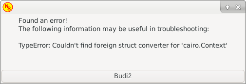

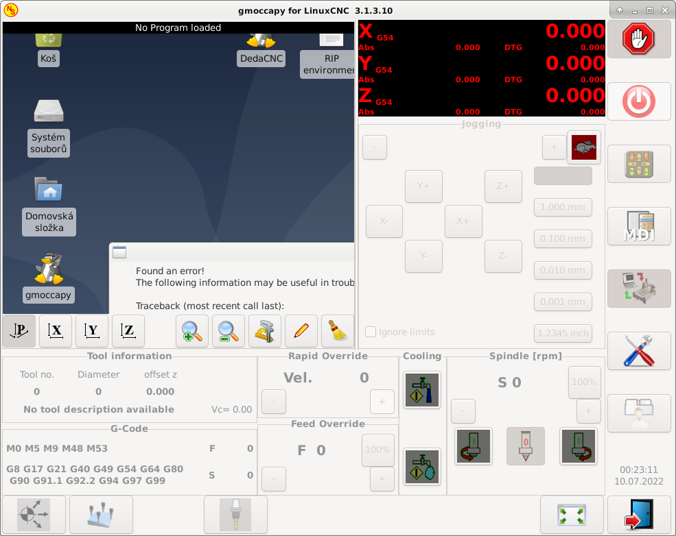

RIP LCNC 2.9 - Gmoccapy dont work [SOLVED] was created by zz912

install
sudo apt install gnome-icon-theme
it will more than likely sort out the iasue

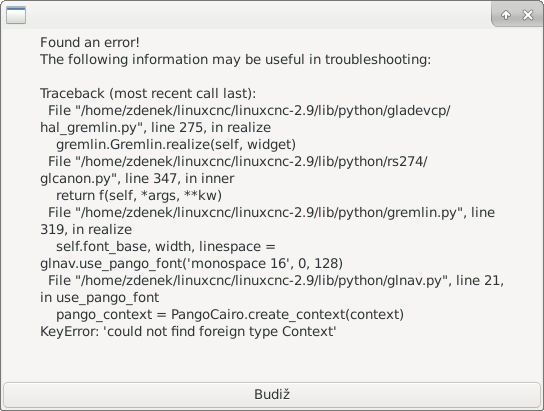

I installed it. I rebuild LCNC. But nothing happen.

I solved it:
sudo apt-get install python3-gi-cairo

You probably should make sure you have the rest of the dependencies:
