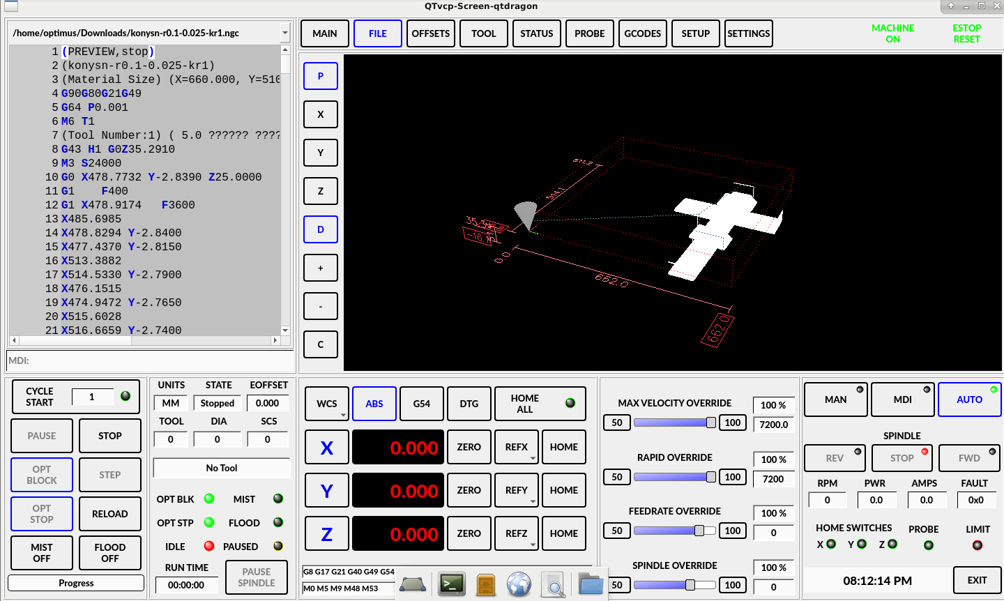

11 Oct 2022 17:16 - 11 Oct 2022 18:03 #253972 by tarasko
Replied by tarasko on topic How to disable preview in Gmocappy
Unfortunately it doesn't work for qtdragon shipped in 2.8.4-8-g6bd693e60.
I added (PREVIEW,stop) into the ngc file and preview is still does exist.
Please examine attached image
Last edit: 11 Oct 2022 18:03 by tarasko.

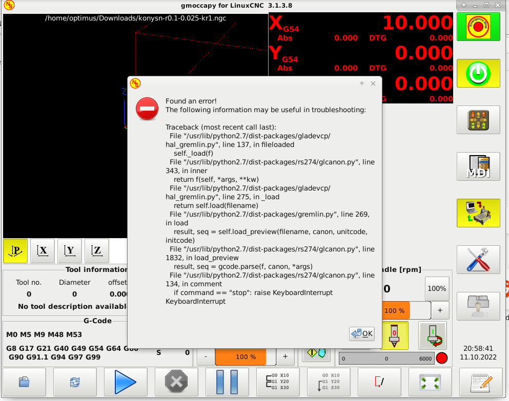

11 Oct 2022 18:02 #253974 by tarasko
For gmocappy of linuxcnc 2.8.4 (AXIS,stop) command does what I need. But also with some errors at the start of file load and when I settings G54 offset of loaded path.
13 Oct 2022 10:16 #254059 by HansU
Replied by HansU on topic How to disable preview in Gmocappy
So (AXIS,hide) doesn't decrease the CPU load?
I guess it works with (AXIS,stop) because it makes gremlin terminate because of that exception...
