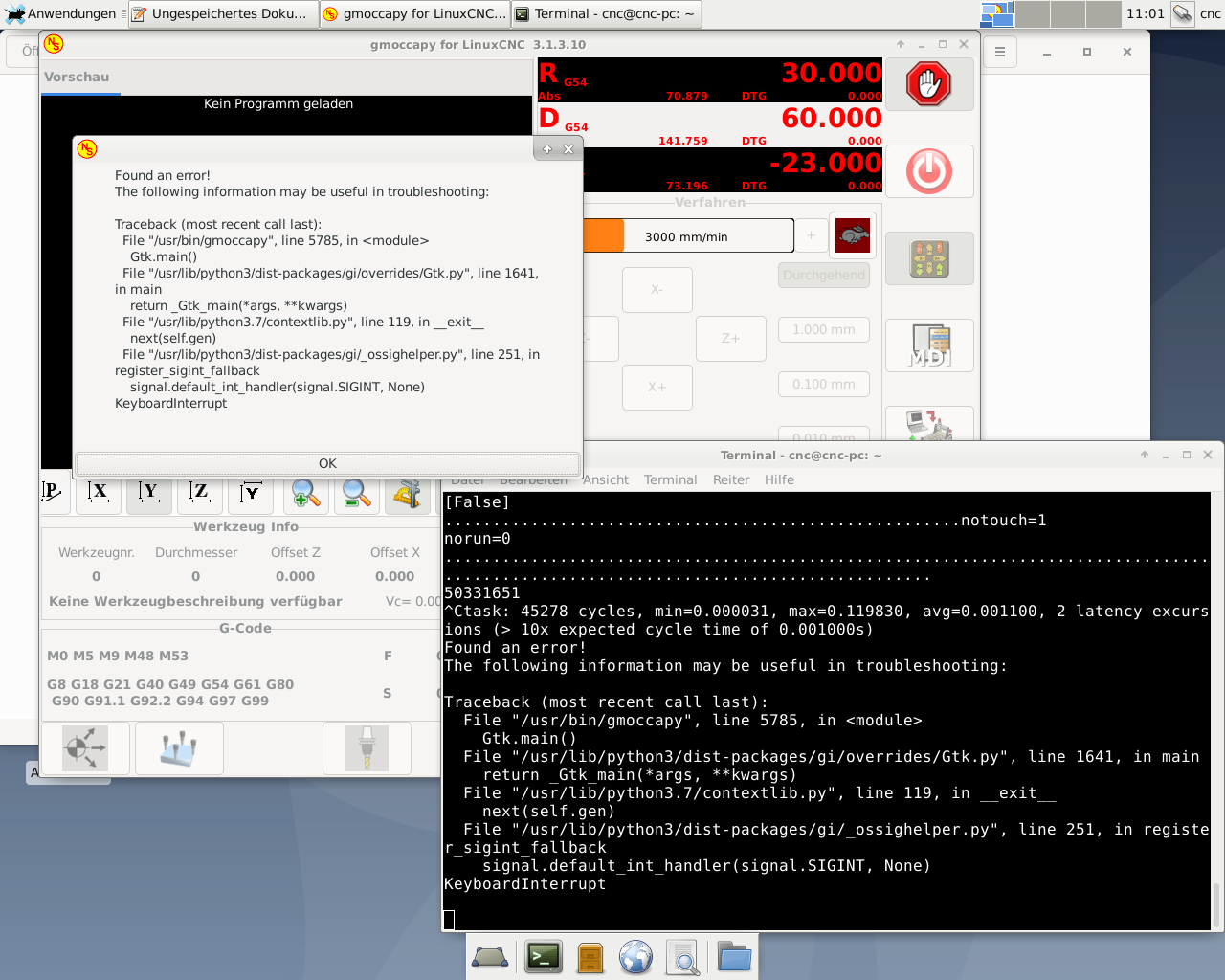

Hi
i did some Updates in the Education center in Germany ALL Mill are OK
But i ran into a problem sim.gmoccapy.lathe_configs.lathe_macros
as bevore 7130 pre of the buildbot it worked then it doesent
the 15 education pc are different so i cand copy the files over Fujitsu Siemens
i add the messages Linuxcnc outputs
INSTALL is frech Clear system from the ISO of linuxcnc Debian10 and 2.8.2
updated to 2.9 as of this Lathemacros needed
THE axis gui and touchy show up the macros as expected
the latheMacro.ui itself runs as standalone in the gmoccapy machine Folder
WHAT hapens or way to reproduce
start linuxcnc from Terminal start sim.gmoccapy.lathe_macros
only preview frame is loaded inside the main window frame of gmoccapy is visable
after it Fails to load i press CTRL+C then Gmoccapy shows up
and the Error message is presented
Full Mesage and screenshot atatched
Please Help

45278 cycles, min=0.000031, max=0.119830, avg=0.001100, 2 latency excursions (> 10x expected cycle time of 0.001000s)
Found an error!
The following information may be useful in troubleshooting:
File "/usr/bin/gmoccapy", line 5785, in <module>
Gtk.main()
File "/usr/lib/python3/dist-packages/gi/overrides/Gtk.py", line 1641, in main
return _Gtk_main(*args, **kwargs)
File "/usr/lib/python3.7/contextlib.py", line 119, in __exit__
next(self.gen)
File "/usr/lib/python3/dist-packages/gi/_ossighelper.py", line 251, in register_sigint_fallback
signal.default_int_handler(signal.SIGINT, None)
KeyboardInterrupt
_kill_dynamic_childs
Note: Using POSIX realtimeFull Mesage and screenshot atatched
Please Help
