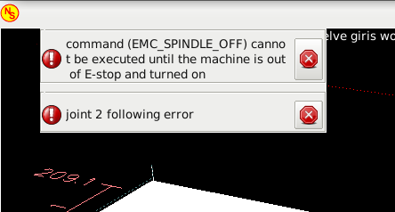

Hello,
I have this G-code file
leteckaposta.cz/408997868
It has only 51Mb.
When I run this program, after a random amount of time the machine stops and displays this error:
Does anyone know what this error means?
I can rule out a miswired wired Emergency STOP button as I have it disabled.
Computer latency is also good.
The problem occurs on two completely different computers.

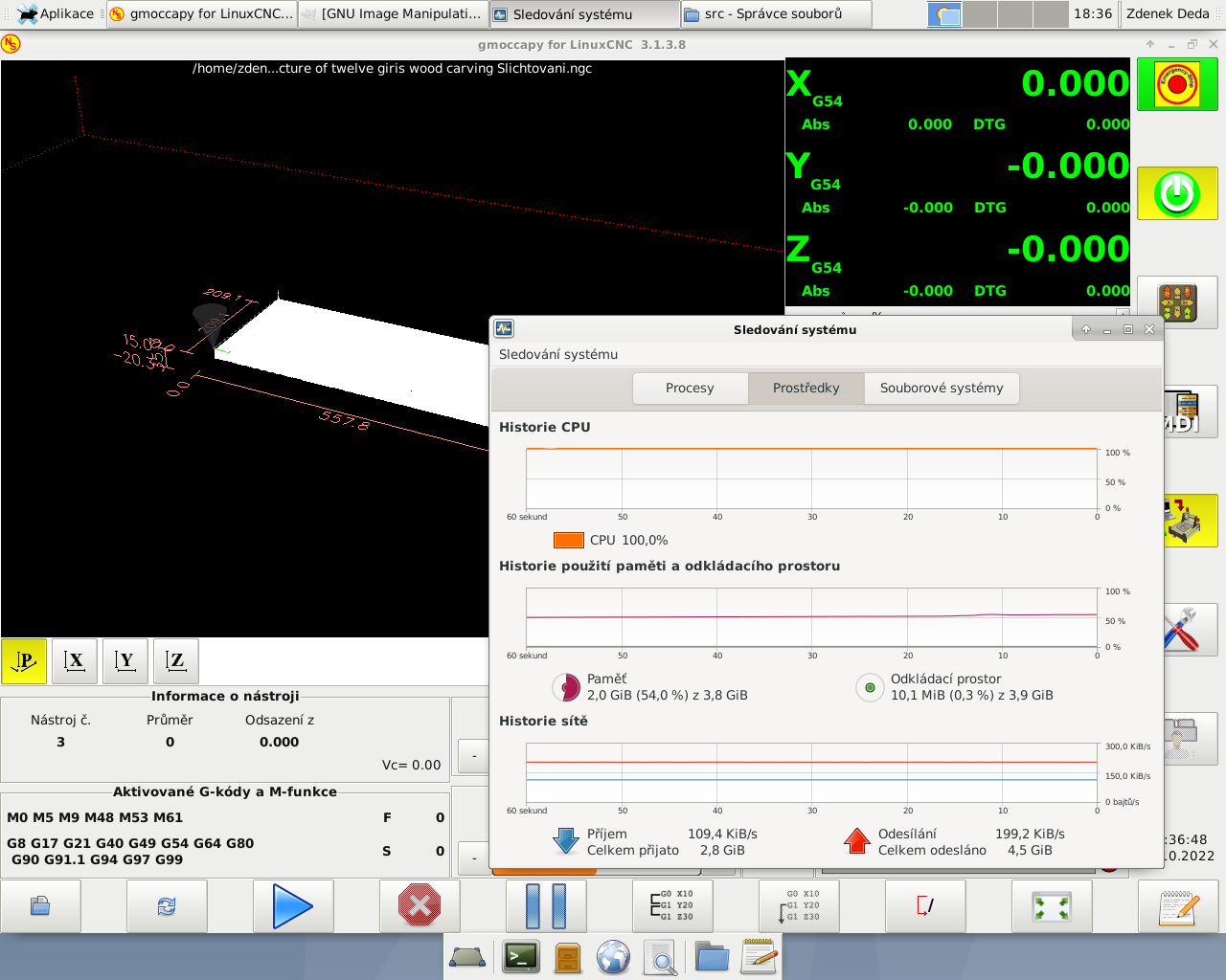

I don't know if this is related to my problem, but I found that if I just load this program I get 100% CPU usage. The processor is still busy even though I'm doing nothing. Preview rotation is choppy and slow.

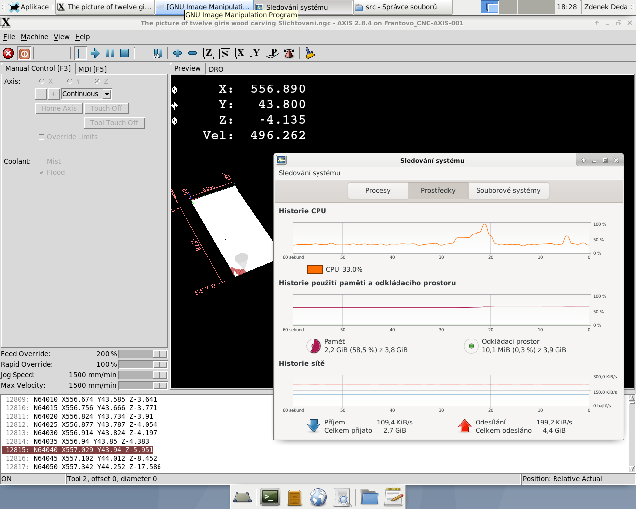

When I load this file in the AXIS GUI, the CPU usage is fine. I can have the program running, I can rotate with the preview. The preview rotates beautifully smoothly according to the mouse movements, but I don't use the CPU at 100%.
I tested Gmoccapy in version 2.8.0 and also in version 2.8.4. The behavior is the same.

I was wondering if your realtime threads were using up all the CPU time, but if it is OK with Axis and not with Gmoccapy then I think that the problem must be elsewhere.
Can you see which porcess is using all the CPU? (I would use top but there is probably a graphical tool too)

the Gmoccapy error 'spindle off etc' is unimportant, it's just the code turns the spindle off after the machine has tripped for joint folling error and of course cannot.

Joint errors are almost always due to velocity/accelerations not correct in the ini file.
Granted, on steppersystems with no feedback to LinuxCNC.
As for load with gmoccapy, run a terminal and type
sudo top
That will show what process is using resources, at least a direction on where to look further.
