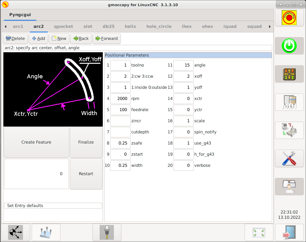

Do you mean the Conversational Shape Library (linuxcnc.org/docs/2.9/html/plasma/qtplas...tml#qt_shape-library) ?
If you men that, you can embed ngcgui (pyngcgui) (linuxcnc.org/docs/2.9/html/gui/ngcgui.html) in Gmoccapy. I added a sample config recently to the 2.9 version, called "gmoccapy_pyngcgui".
Some basic shapes are included, but it can be simple extended by G-code.

Yes thats ir. Realy Nice.
i Will try to implement embebed in gmoccapy.
This for me Will bem realy useful for aluminium profiles for Windows since we always use the same cycles / routines only with rectangles, circles, and some combinations of the same.
