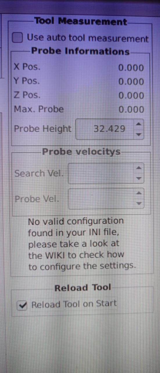

I'm getting this no valid configuration found when i try to use the auto tool measurement in gmoccapy.
Simulated versions run fine. But anything i create with the stepconf seems to miss something. I tried copying the postgui hal from gmoccapy sim to the directory and including everything from the sim ini to my ini file but can't seem to get this to work?
What am i missing here? What is a best path to create a proper gmoccapy configuration?
Any help is appreciated.

Ok. Got it to work. These are the steps if anyone finds themselves in a similar situation.
By this time I have created a working Gmoccapy config with stepconf (pnconf will have the same issue i guess)
1. Create a simulation config of Gmoccapy-tool_sensor from linuxcnc sims.
2. After the folders are created for the simulation config, Copy the folling to your machine config folder
- macros folder
- python folder
- gmoccapy_tool_sensor.para
- tool_sensor.hal
3.Then copy these lines to your machine ini file from the Gmoccapy-tool_sensor ini file under the correct section. Ex- [DISPLAY]

4. Then in you hal file you will probably have something similar if you have a manual tool change selected.
net tool-change iocontrol.0.tool-change => hal_manualtoolchange.change
net tool-changed iocontrol.0.tool-changed <= hal_manualtoolchange.changed
5. remove those lines from your hal file and add these to your custopm_postgui hal file.
net tooloffset-z gmoccapy.tooloffset-z <= motion.tooloffset.z
6. After that hopefully Gmoccapy will happily to a auto touch off when you do a manual tool change.
This was the first time i came across such a thing and this was my solution to it. People who understand better will be able to do a better explanation. What I did was tried to figure out how the auto touch off worked and then pieced it together like a caveman.
