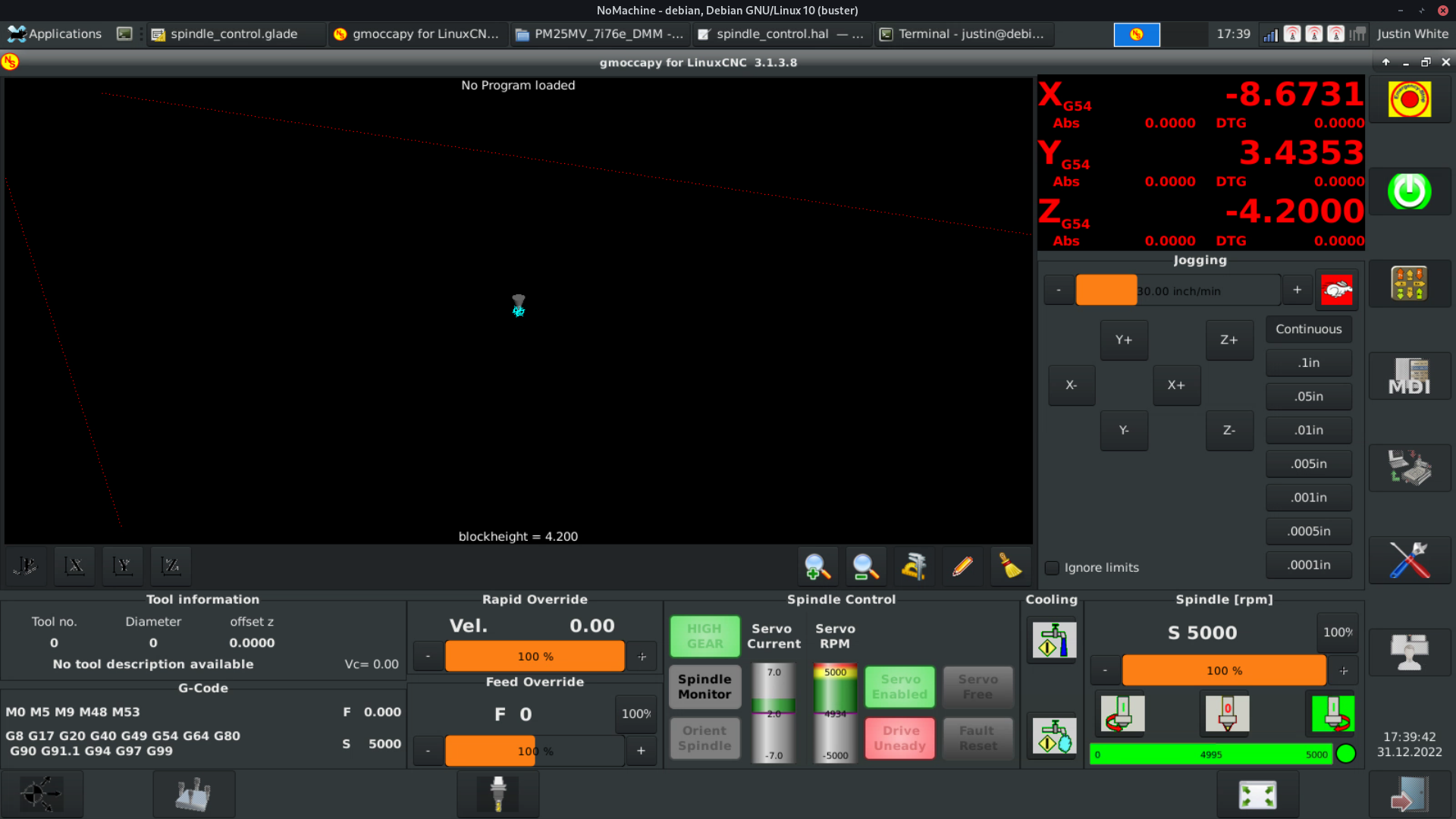

I was having some odd issues (probably CAM related) with a Mill running gmoccapy/LCNC 2.7(I think). It's been setup the same way for over 2 years, with a gladevcp custom panel embedded in  "EMBED_TAB_LOCATION = box_custom_3". I decided to migrate this thing to a new PC and 2.8.4 from the ISO. I started off copying the config.
Originally the HAL connections for the custom panel were made in custom_postgui.hal. This seems to be a problem now for some reason. Reading the Gmoccapy docs it says
If you make any hal connections to you custom glade panel, you need to do that in the hal file specified in the EMBEDDED_TAB_COMMAND line
Since I'm having trouble I did it that way even though it wasn't the case before. The gladevcp panel is named "spindle_control.glade". I copied out the hal connections and put them into a file "spindle_control.hal". My postgui_call_list.hal is:
source HAL_Files/custom_postgui.hal
source HAL_Files/spindle_control.hal
I will get the error:
**** GMOCCAPY INFO : postgui halfile = HAL_Files/postgui_call_list.hal ****:
HAL_Files/spindle_control.hal:6: Pin 'spindle_control.hal_vbarSpinMspeed' does not exist
If I comment out the "source HAL_Files/spindle_control.hal" line, LinuxCNC will start. In halshow I can see that all the pins created in the panel exist (without connections obviously). I can copy a net line from the spindle_control.hal file and make the connection in halshow, so the panel, and it's gladevcp pins are working. It looks like Gmoccapy is loading the panel too late, after it's hal file has tried to load.
I've tried to omit the postgui_call_list.hal from the ini and load both the custom_postgui.hal and spindle_control.hal as POSTGUI_HALFILE's from the ini but it appears that you cannot load 2 postgui hal files from the ini, the 2nd just doesn't load. I've tried TWOPASS=on which does not help. Attaching the config cuz someone will probably ask but I'm fairly certain this is a loading order/timing issue. Any fix or workaround?

I've been messing with this for a while now. I went back to the manual and noticed the gladevcp -H option. I also spoofed a pncconf gmoccapy config so I can see what it does. I setup a gvcp_call_list command file just like pcnconf does.
So now LinuxCNC sill start, the custom panel and hal file will crash and gmoccapy will print that the pins don't exist, however they do....halshow will show the pins and they've even connected to the signals. There is an analog pin connecting to a Vscale that I can watch dance around in halshow so the pins definately netted. I hope I'm missing something because now I'm really confused.
I checked the gvcp-panel.ui that the pncconf config generated and that is a gtk2 panel just as mine is so that shouldn't be a problem.
31 Dec 2022 04:04 - 31 Dec 2022 04:14 #260605 by blazini36
Replied by blazini36 on topic Custom Panel's HAL file cannot load postgui?
It sounds like you're "spindle_control.hal" file isn't saved in the dir that Linuxcnc is looking for it in.  Is it saved in the same place as the file "custom_postgui.hal" is?  Alternatively you could add the lines from the spindle_control.hal to the custom_postgui.hal and use only that one.
The error I posted in code tags is from the hal file trying to make a connection to a pin that does not exist. It does not exist because the gladevcp panel has not loaded it yet. If the hal file didn't load, there would be no error as I mentioned as a test I commented out the line to load the hal file. Obviously in that case there are no pin connections either. Also as I mentioned the original config I migrated from was just 1 file, it was all in "custom_postgui.hal". Something has changed where this is not possible anymore, I've seen it mentioned while searching.
As I mentioned in the 2nd post I made. Using the gladevcp -H option still throws console errors....and the panel crashes, but all gladevcp pins created and netted if not for the fact that.....well the panel is not visable, it would be working. Forgot to mention in the last post, this is what I'm launching the tab with now...
EMBED_TAB_NAME = spindle_control
EMBED_TAB_COMMAND = gladevcp -c spindle_control -H HAL_Files/gvcp_call_list.hal -x {XID} GUI_Panels/spindle_control.glade

So I did manage to get it working by adding connections back to the spindle_control.hal file little by little. It looks like there were a couple of errors that 2.7 didn't seem to care about that 2.8.4 actually does. I can believe that because I know earlier versions of LCNC let you get away with things in postgui files that were technically illegal.
For reference,
net machine-is-on <= spindle_control.HLB_ServoFree-enable
was bad because the glade file didn't have the option set to "Create enable pin"
and
net GUI-spindle-drive-enable  => spindle_control.HLB_ServoFree-light
net spindle-drive-enable      => spindle_control.HLB_ServoFree-light
Is an error because 2 output signals are connected to 1 input pin. So it looks like the errors it was giving me about "pin xxx does not exist" is because the panel/halfile crashed with the errors before those pins were created. So it looks like you just have to be careful messing with postgui files in 2.8.4 as it will catch the errors but the reporting is likely to be off.
