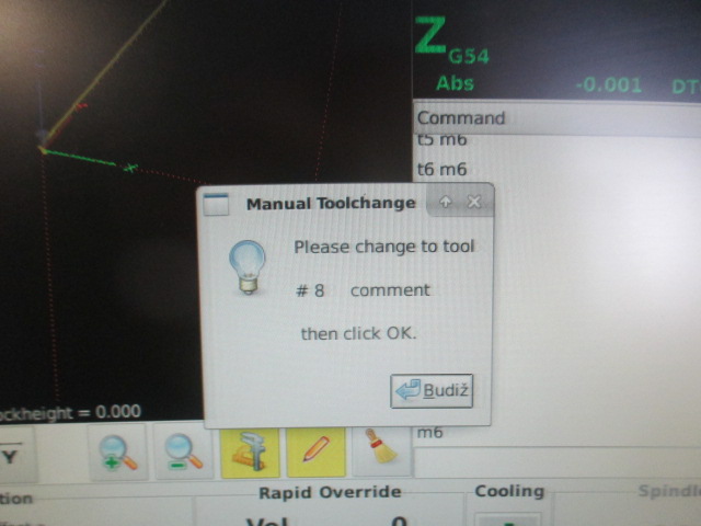

Hello,
simple question. How I can disable manual tool change dialog in gmoccapy 3.1.3.8?
Im using my own M6 and random tool changer. I have 2 machines one using linuxcnc 2.7 one 2.8.
Code and configuration is same but at 2.8 lcnc is showing this dialog.
I can send hal, ini no problem.

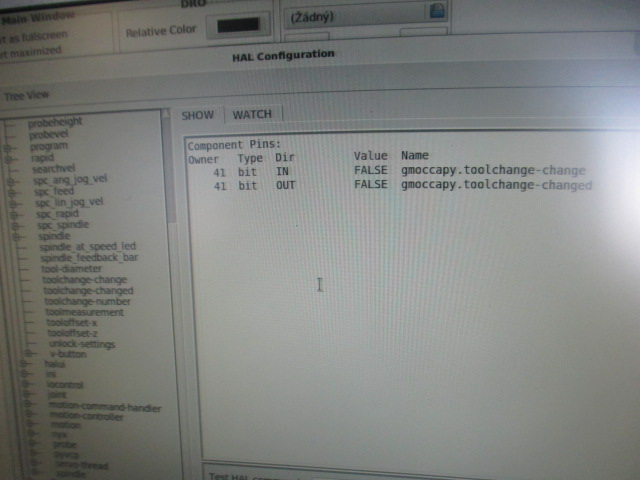

16 Mar 2023 12:04 #266829 by MichalHK
Replied by MichalHK on topic Disable manual tool change dialog
Yes that was first that I check.
Problem is that I dont using this pin in hal. So I think all pins is disconncted.
Another problem is I dont see gmoccapy.toolchange-confirm pin.
Misterious are that I click to gmoccapy.toolchange-change pin in halshow. I see toolchange-change and toolchange-changed pin.
16 Mar 2023 13:29 - 16 Mar 2023 13:30 #266835 by HansU
Replied by HansU on topic Disable manual tool change dialog
Sure? Also not in the postgui-halfile? They are connected there by default.
If those pins are not connected, Gmoccapy won't pop up that dialog.
That's probably because I linked to the 2.9 documentation, sorry. 2.8 does not have that pin.
But that pin is not relevant here.
Only a little uncertainty in halshow. It just does "halcmd show pin gmoccapy.toolchange-change" which lists you both pins.

16 Mar 2023 16:10 #266842 by MichalHK
Yes I checked postgui-halfile list many times. Also check halshow and pins is not connected.
Then edit /usr/bin/gmoccapy line 4422.
There is definition def on_tool_change i simple rewrite it that only set self.halcomp["toolchange-changed"] = true
No show some dialog window atc... simple set variable to true.
Restart Lcnc and nothing happend. Dialog is still there. So I have no idea which code call it.

20 Apr 2023 05:02 #269468 by newbynobi
Replied by newbynobi on topic Disable manual tool change dialog
@Jeff_in_Wa: This is to disable the tool change window, not the tool change itself!
I would try to connect gmoccapy.tool-change with gmoccapy.tool-changed without connected them ti iocontrol.
Norbert
21 Apr 2023 10:28 #269544 by MichalHK
Sorry it was my fault. Today I found that I havent connected iocontrol.0.tool-changed pin.
Thanks so much all.
