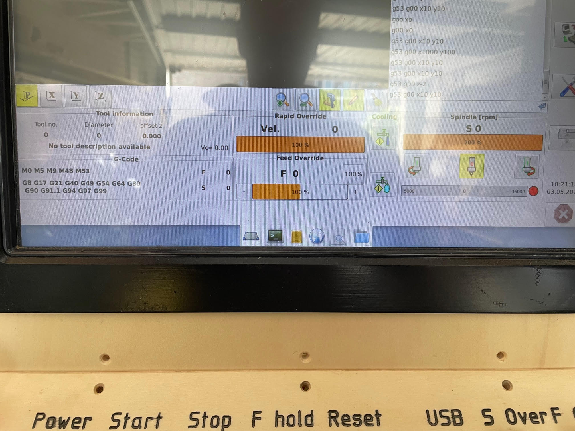

Hello All,
i have read a lot about the useage of Macro Buttons in the Mode MDI
Current versin LCNC 2.8.4
Current version GMOCAPPY 3.1.3.8
I woud like tu use macros buttons in the MDI mode.
what do i Wrong in the ini file or ngc file, both add in this message

Two things I notice:
1. SUBROUTINE_PATH: "The list must contain no intervening whitespace." So remove the spaces. You can also try to remove the part after the colon, shouldn't be needed.
2. (msg, diameter circel is #1) --> (msg, diameter circel is [#1])
If that doesn't help have a look at the gmoccapy sim config:
github.com/LinuxCNC/linuxcnc/blob/2.8/co...moccapy/gmoccapy.ini
github.com/LinuxCNC/linuxcnc/blob/2.8/co...macros/increment.ngc

03 May 2023 08:51 #270545
by CNCGOOS
Replied by CNCGOOS on topic MAcro buttons in MDI will not show
i have changed it all but nothing will
appears in the bottom Row. as shown in the Picture.
What did I forget to set that the macros appear in the bottom bar
file name is the same as marco name and also the name in the ini. all lowercasse

03 May 2023 12:47 #270562
by 0x2102
Replied by 0x2102 on topic MAcro buttons in MDI will not show
Sorry, please ignore what I said before, to remove "diameter" this is actually the parameter it asks you for when you run the script.
My macro icons disappear when I rename my macro folder (did this as a test). So I assume your search path was/is not correct in your INI.

- CNCGOOS
- Posts: 28
03 May 2023 13:24 #270565
by CNCGOOS
I have to do it like this
SUBROUTINE_PATH = /home/joost/linuxcnc/nc_files/macros
SUBROUTINE_PATH = macros
was not working
just like this
(IMAGE,./macros/Button_Image/cirkel_binnen.png)
i have change it to the next row
(IMAGE,/home/joost/linuxcnc/nc_files/macros/Button_Image/cirkel_binnen.png)
was not working
just like this
