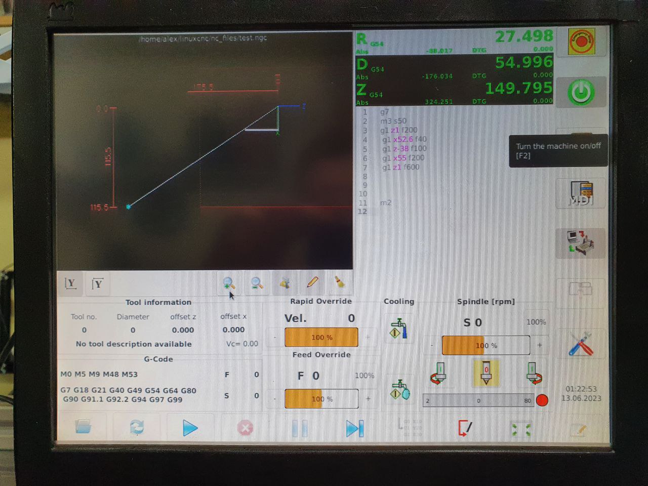

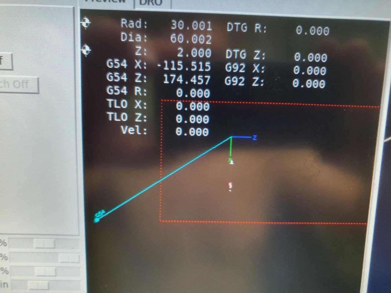

Hi all,
that is probably not a gmoccapy but gremlin problem, but I did not find better place to post it.
I've built a lathe cnc based on 2.9 dev branch (RIP build), it works fine except one problem. No matter what I do and what do I do in the gcode, the preview always show a dashed line to some point out of working area. I've never saw it on milling linuxcnc configs.
As I can see the point offset somehow correspond to G54 offsets.
Is it a known problem and is there a way to fix it?
my ini file:

3 years 4 months ago #273470
Replied by tommylight on topic Lathe path preview looking strange

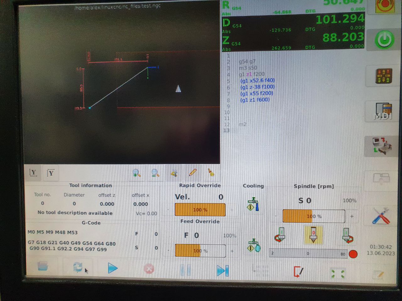

Seems there are active offsets, the blue-green ball shaped thingy in gremlin preview.

3 years 4 months ago #273477
by alex_sar
Replied by alex_sar on topic Lathe path preview looking strange
Thanks for response!

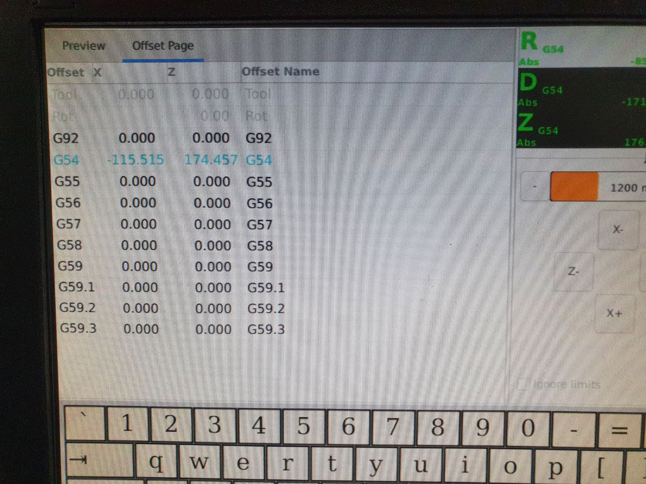

Do you mean G92 offsets? That is a new setup and I definitely did not use any offsets besides G54.
But I will check to make sure all possible offsets are zero.

3 years 4 months ago #273489
by scotth
Replied by scotth on topic Lathe path preview looking strange
The HOME_OFFSET values look large. It may be because of the absolute encoders, just a guess.

3 years 4 months ago - 3 years 4 months ago #273490
by alex_sar
Yes, I'am using MR-J4-B with absolute encoders, and offset values are correct. I think it should not break anything in UI, and if it breaks it is better to get it fixed.

3 years 4 months ago #273491
by scotth
I don't run gmoccapy, but can you shrink the display enough to see the other end of the dotted box. I believe that is the defined work envelope displayed.

3 years 4 months ago #273492
by alex_sar
Yes, red line is probably work area and that is not a problem.
Problem is diagonal line going left down corner. There is nothing like this in the g-code and it breaks preview, and also invalid numbers displayed because of this.

3 years 4 months ago #273497
Replied by Aciera on topic Lathe path preview looking strange
The light blue symbol would be your machine absolute zero and I think the preview can be made to display a light blue line with a label showing the current work offset.
But why it would show a gcode move from machine zero to the current work offset I really don't know.

3 years 4 months ago - 3 years 4 months ago #273505
by alex_sar
Thanks all!

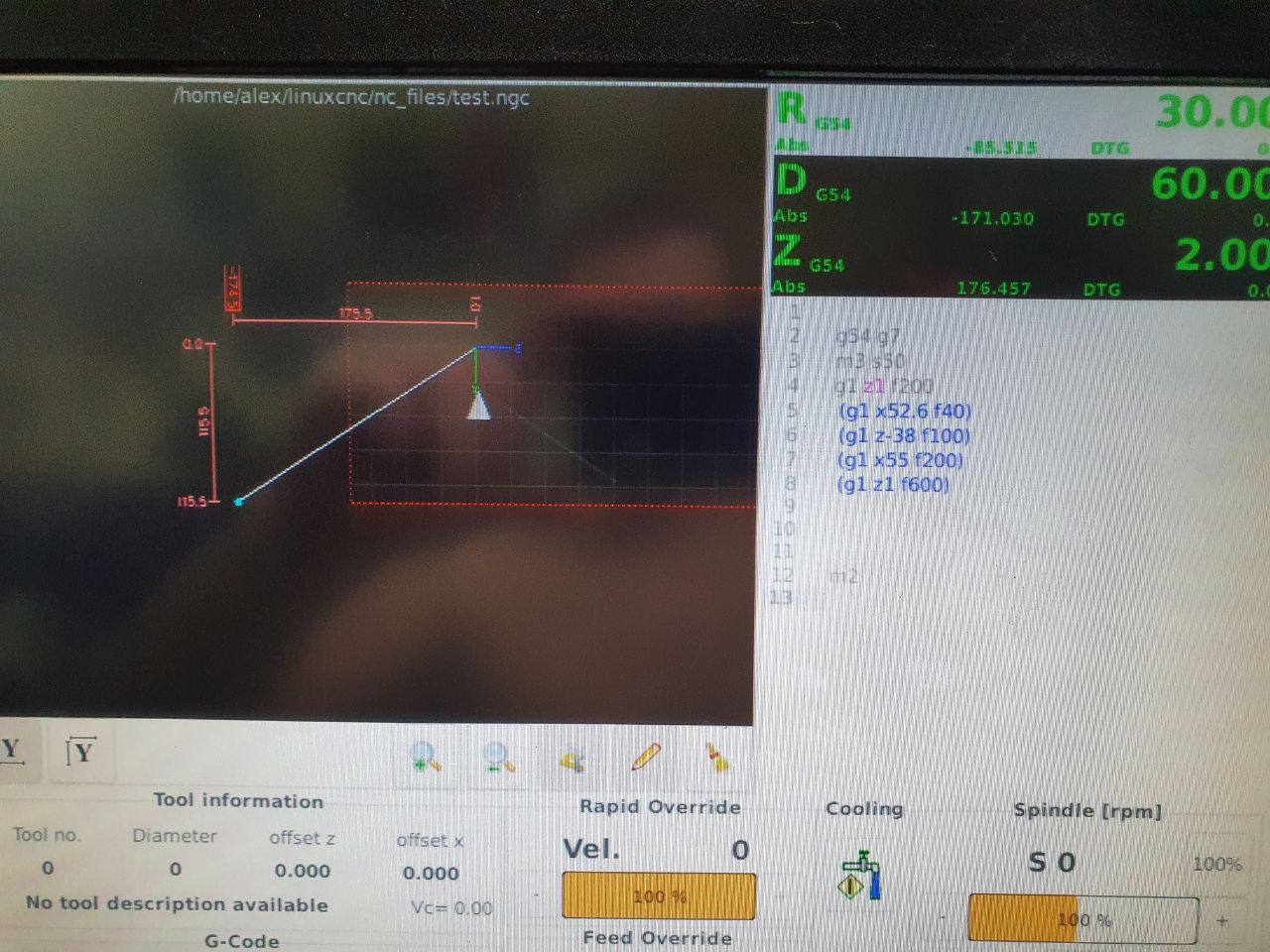

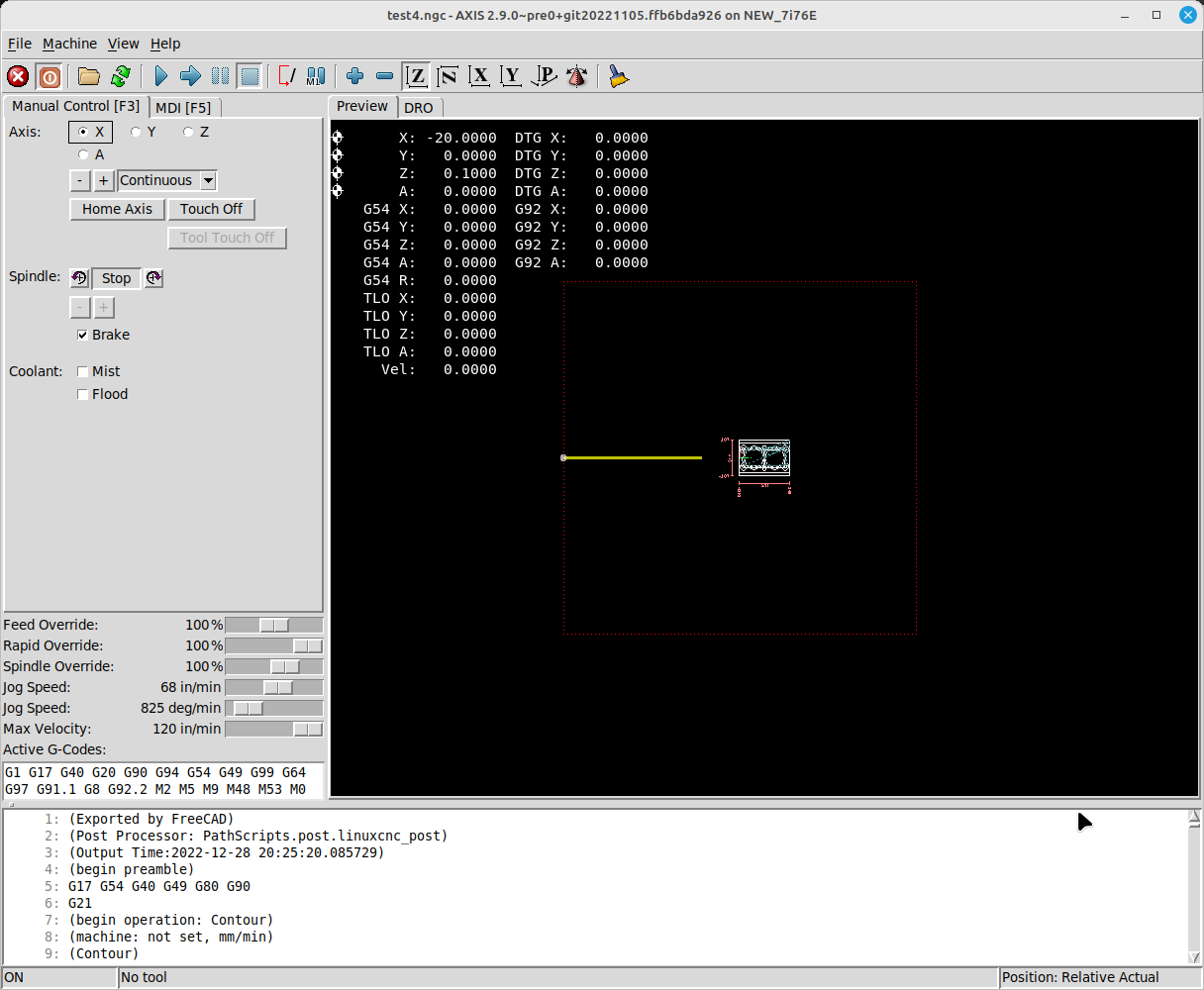

I checked offsets, there is no any besides G54 and it definitely displays G54 offset. I've tried with AXIS and it displays similar picture but with G54 label on point.
The question is how to disable it in gremlin? I am a programmer, if someone point me where to look, I will be happy to submit a patch to linuxcnc github for this.
This makes preview partially useless, because I do not see clear minimal Z and X on preview, which is very important for safety before start turning program.
