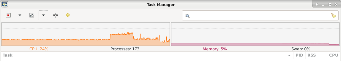

13 Jun 2023 18:01 - 13 Jun 2023 18:02 #273503 by knipknap
Replied by knipknap on topic UI unresponsive on larger files
It looks like it is CPU related after all, but I found no solution. Here is a screenshot of CPU utilization:
The time where utilization is 50% is where the UI is frozen. Since the CPU has 4 cores and the base load is 25-30% when the UI is not frozen, I'd say this looks like one core being fully utilized - probably the core that is also supposed to update the UI. Still no idea what causes this and how to prevent it.
Last edit: 13 Jun 2023 18:02 by knipknap.
