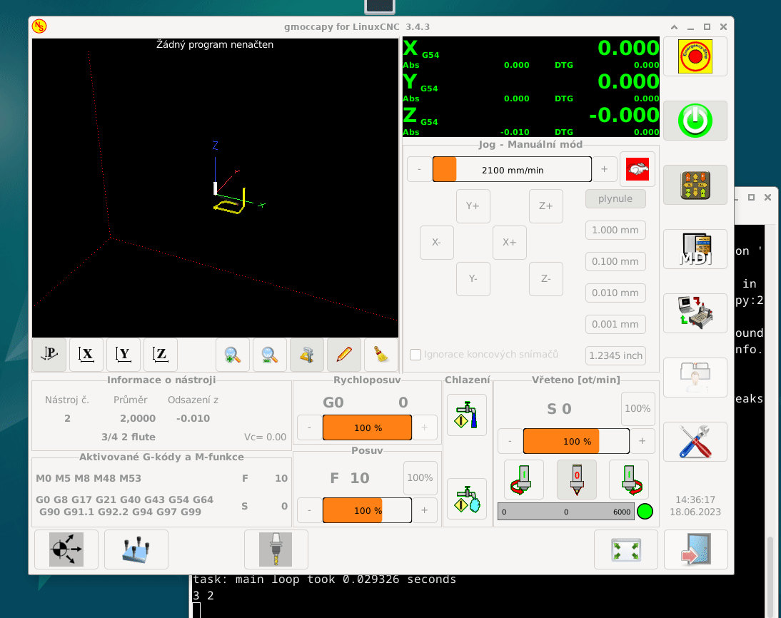

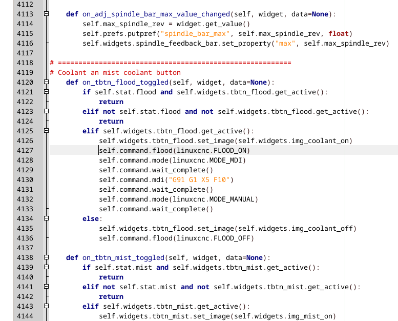

Hello,
I wanted to start experimenting with the self.command.wait_complete() function
I wanted to use the cooling button.
I added the following lines to the source code:
self.command.mode(linuxcnc.MODE_MDI)
self.command.mdi("G91 G1 X5 F10")
self.command.mode(linuxcnc.MODE_MANUAL)
Unfortunately, it doesn't behave at all as I would imagine. Does anyone know why?

I solved it.
self.command.wait_complete() has time limit.
Sorry for the spam.
On the other hand, if self.command.wait_complete() times out, a warning message could be issued.
Sorry for the spam.
