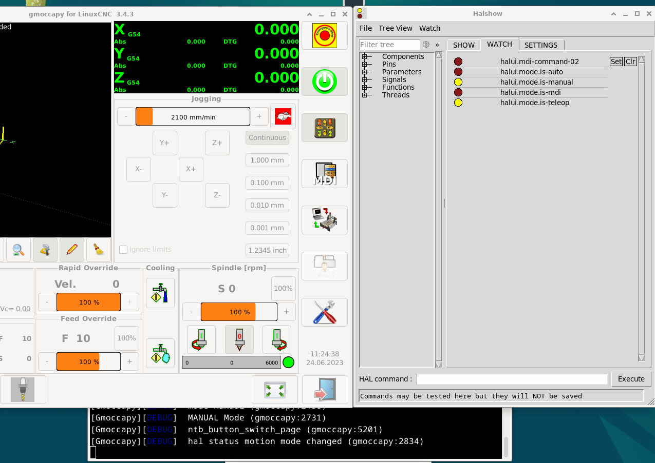

24 Jun 2023 10:08 #274170 by zz912
Hello everybody,
So I found time to test LCNC again. I think the conclusion of the previous test is clear. Not using self.command.wait_complete() can lead to unexpected LCNC behavior. If we wanted to avoid this unpredictable behavior, we just need to add self.command.wait_complete() after each self.command.mdi().
The result of today's test surprised me.
In the gmoccapy.ini file, in the HALUI section, I added:
MDI_COMMAND = G91 G1 Y1 F10
In the gmoccapy.py file, in the on_tbtn_flood_toggled section, I added:
            self.command.wait_complete(30)
            self.command.mode(linuxcnc.MODE_MDI)
            self.command.mdi("G91 G1 X1 F10")
            self.command.mode(linuxcnc.MODE_MANUAL)
Video:
If I run the Python Interface command separately, everything goes fine.
If I run "HALUI - MDI COMMAND" separately, everything goes fine.
If I run the command Python Interface and then run the command "HALUI - MDI COMMAND" the Python Interface and "HALUI - MDI COMMAND" is aborted.
If I do it the other way round I run HALUI - MDI COMMAND and then run Python Interface command "HALUI - MDI COMMAND" is executed and Python Interface is not executed This produces a message: "Must be in MDI mode to issue MDI command".
  • zz912
  • zz912's Avatar Topic Author
  • Offline
  • Platinum Member
  • Platinum Member
25 Jun 2023 17:40 #274203 by zz912
Hello everybody,
I spent the whole day thinking about what to conclude from the previous test.
First half of the test:
I decided to consider this LCNC behavior and not do anything about it. If one wants to avoid this condition, one runs HALUI MDI-COMMAND via the and2 component and the is-idle pin.
Second half of the test:
