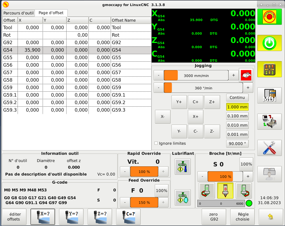

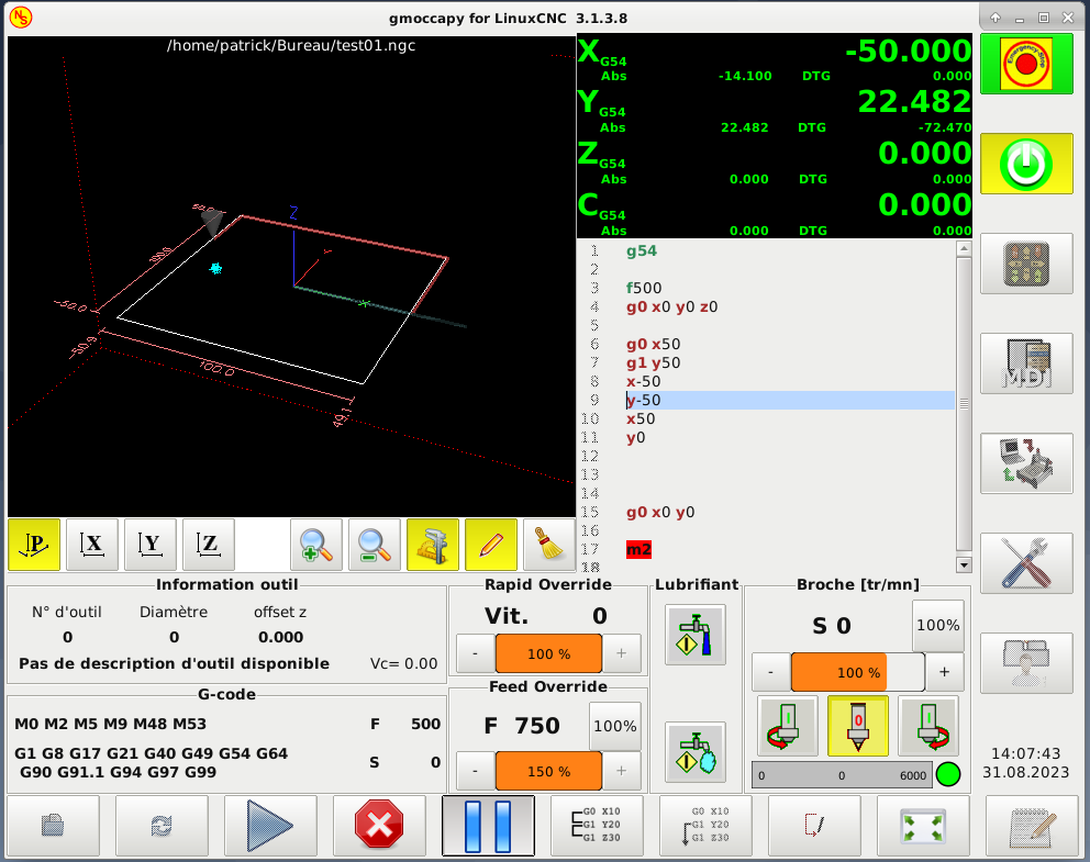

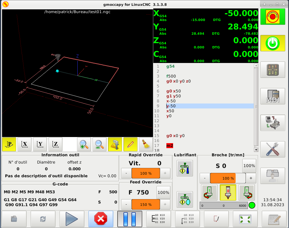

In this example, I quickly see that my tool moves between -50 and +50 on the X axis.This matches my gcode program well.This works well as long as the X, Y, Z offsets of G54 are integers.
Here is an example where the offset on X is 35mm (integer number) for G54:
The path (gcode program) of the tool remains unchanged and the path (machining in progress) is well superimposed.

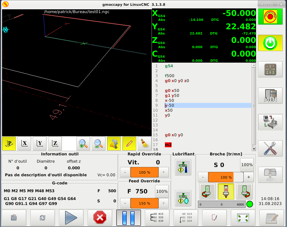

Here is an example where the offset on X is 35.9mm (digit with a decimal part) for G54:
In this case, the path (gcode program) of the tool is offset by 0.9mm: it can be seen on the limits (Xmin = -50.9, Xmax = 49.1) and the path (processing in progress) is not superimposed .
Good news : Actual machining conforms to program and offset G54 The problem is : The display of the white trace and the limits is incorrect (shift of the decimal part of the offset).I have the impression that GREMLIN only receives the entire part of G54.Is this a known issue?Is this a configuration issue?

It is a known bug in version 2.8
Version 2.9 is OK.
forum.linuxcnc.org/gmoccapy/38132-error-offset-in-preview
forum.linuxcnc.org/38-general-linuxcnc-q...ong-preview?start=10
Version 2.9 is OK.
