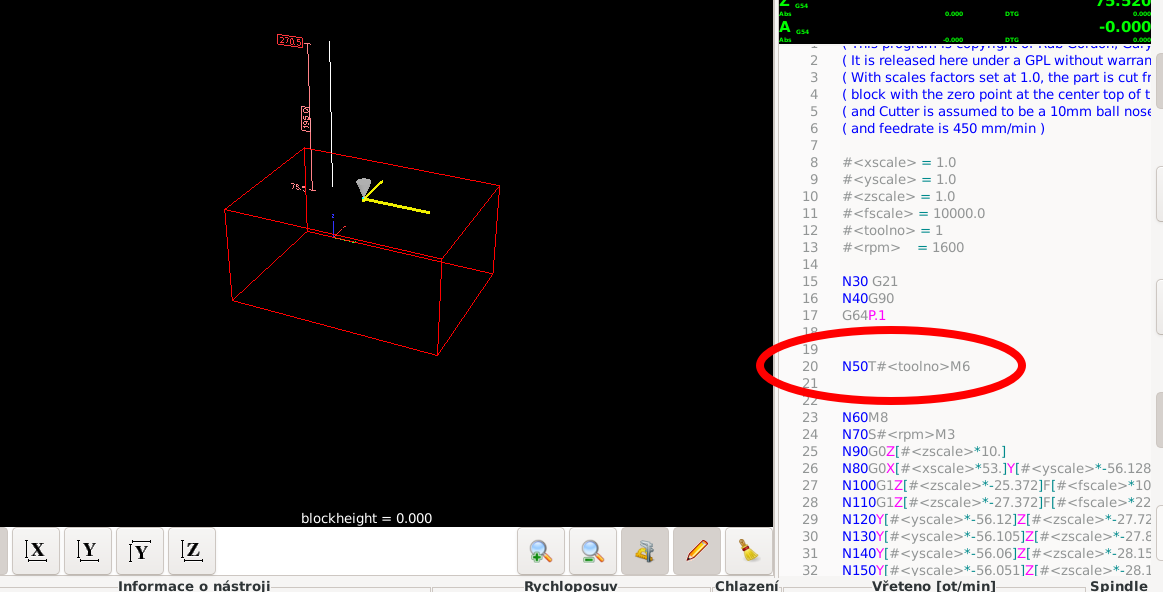

Hello,
I have following problem:
After having updated from pre0.2066 to pre0.2069 there is no more tool race preview on the gremlin.
I hoped the problem was fixed with pre0.2330, but it is still present.
As soon as there is a M6 or M06 in the code, there is no preview.
If the G-Code has no tool change (and therefor no M6) the graphical preview is visible.
This error appairs in both configuration: with or without "remap".

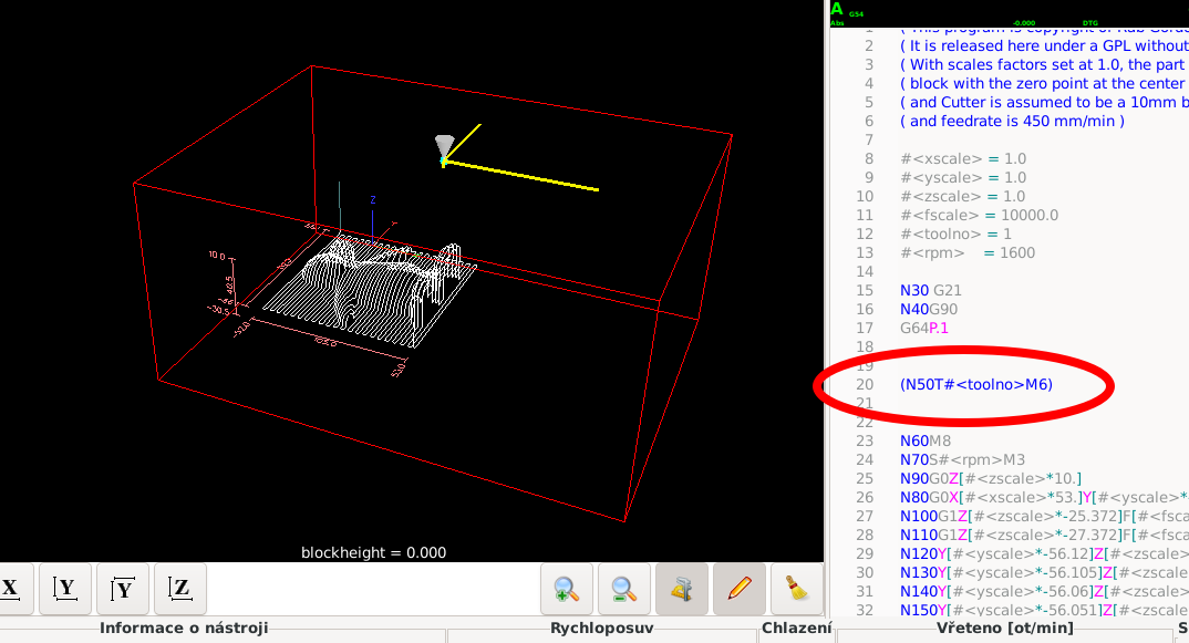

I have same or similar problem in 2.9 version. I have more problems with ATC.
I thought the blank screen was related to this issue:
github.com/LinuxCNC/linuxcnc/issues/2651
Unfortunately, a friend took the machine apart and is moving it. So I can't test what rene-dev advised me.
But there are probably two problems.
1) Problem with the displayed trajectory (it will probably be solved with advice from rene-dev)
2) Problem with the disappearance of preview path from gremlin.
Could you simulate this bug in the sim configuration?

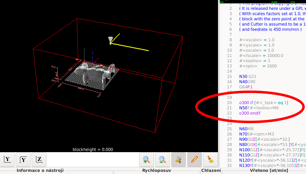

maybe this should help you:
Did you use "#<_task> eq 1" ?
I did not tested it in physical machine yet, but in simulation it works good.
rene-dev helped me:
www.forum.linuxcnc.org/40-subroutines-an...emap?start=10#277509
Zdeněk
o300 if [#<_task> eq 1]
N50T#<toolno>M6
o300 endifDid you use "#<_task> eq 1" ?
rene-dev helped me:
Zdeněk

Would you not rather build that if statement into the remap code itself?
- zz912
- Posts: 596
- Thank you received: 98
22 Nov 2023 20:14 #286269
by zz912
Yes of course, but this is better for testing and explanation.
Replied by zz912 on topic G-code graphical preview (2.10.0 pre0.2330) on GMOCCAPY
