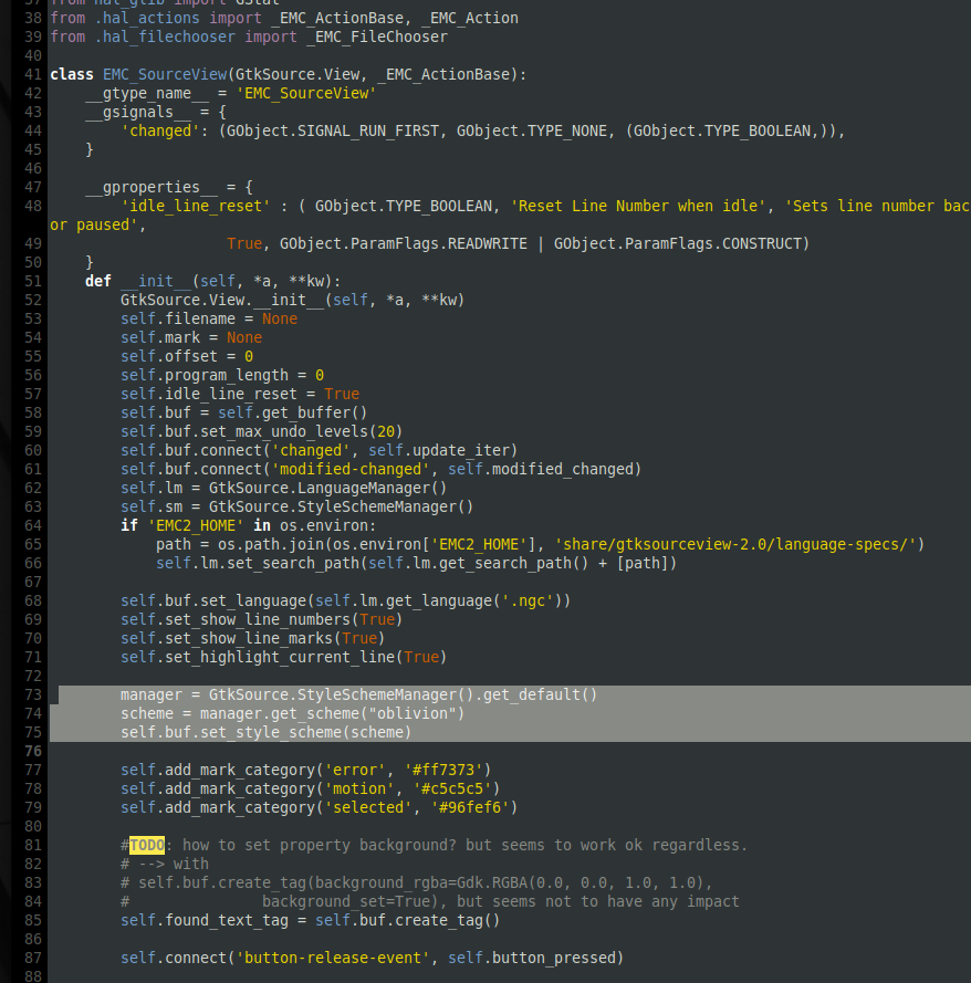

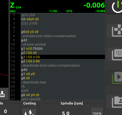

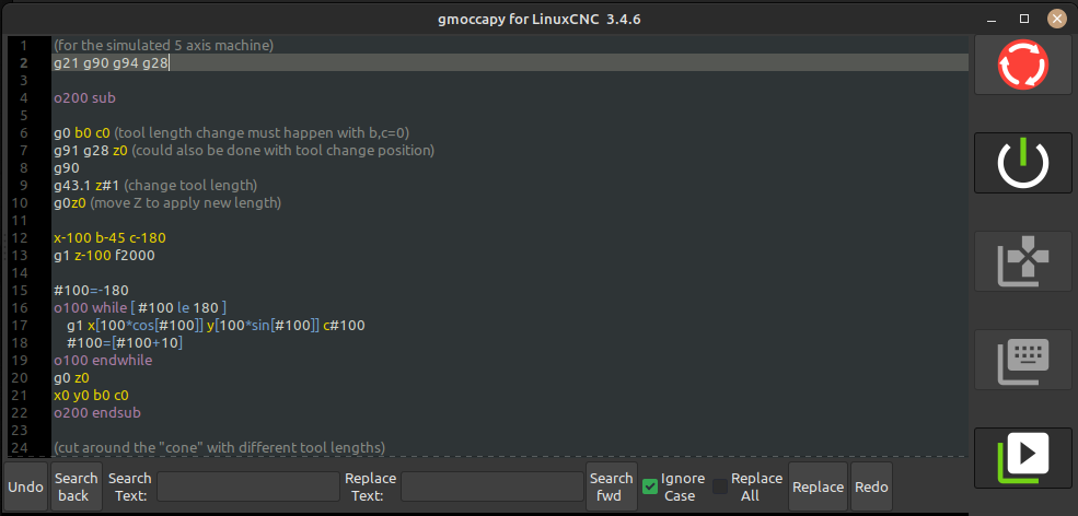

Can I change the colors scheme in the gcode editor? was created by Aciera

I just came here in search of the same answer, we're you able to figure it out ?
Gmoccapy and the editor seem to work great , but that color has to go. The bar or the font.

15 Nov 2023 18:02 #285531
Replied by Aciera on topic Can I change the colors scheme in the gcode editor?
- Posts: 4801
- Thank you received: 2161
16 Nov 2023 07:33 #285585

You can do this without need to change anything in the source code. See forum.linuxcnc.org/gmoccapy/51124-gmocap...release-2-9-2#289264
- HansU
- Posts: 723
- Thank you received: 217
28 Dec 2023 18:51 #289271
by HansU
Replied by HansU on topic Can I change the colors scheme in the gcode editor?
I implemented that now as a setting, so will be available soon
github.com/LinuxCNC/linuxcnc/pull/2811
