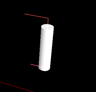

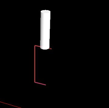

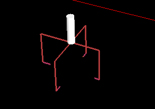

The situation is this - after updating to 2.9, I can't make the probe screen by vers work completely.
I converted one version myself from the verified version to 2.8, the second (newer) version here on the forum. As a result, the same appears in both!!! error - Outside measure X- stops after the macro has been run, does not return the axis to the start position, and does not reset the coordinate.
If you use a complex measurement (for example, the center of a hole or the center of two walls), everything works fine. For more than a week I have not been able to find a solution, like the macro code is identical, the python code for X + and X is also identical.
Who understands the code well - I ask you to help!!!
If moderators think this topic is for another section - please move to the correct one.
In the attachment sim configuration in which you can see the problem
