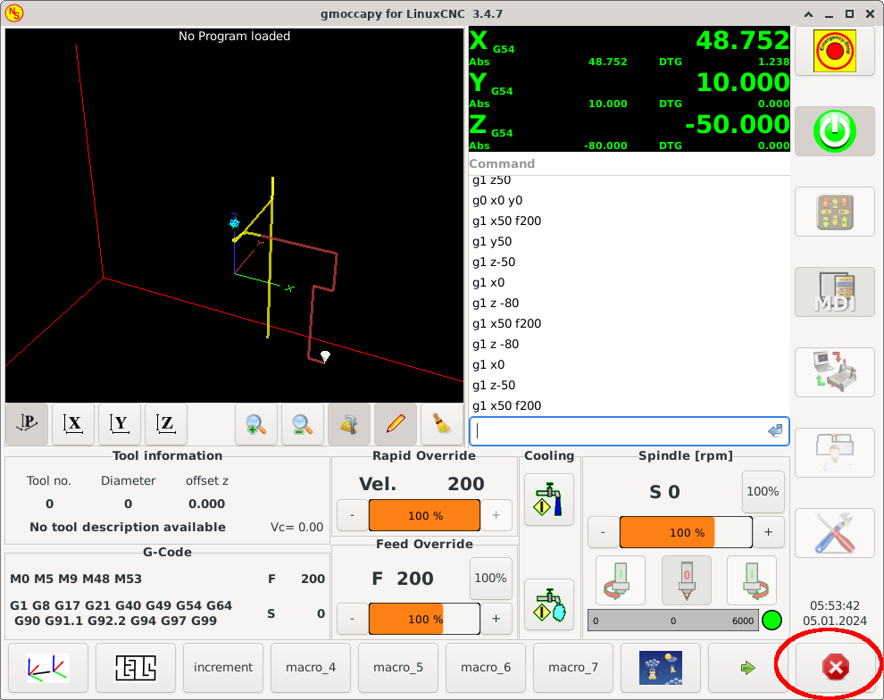

Hello,
again I will try to make a patch for github.com/LinuxCNC/linuxcnc/issues/2489
I don't want to make another mess on github so I opened a thread here.
I would like to ask if someone would show me how the STOP button control works. The button is circled in red in the following image.
I realized that all I need to solve the "M61 + G4" bug is to run AUTOMATIC G43 LINES when this STOP button is deactivated.

I found it.
This show stop button:
github.com/LinuxCNC/linuxcnc/blob/f49bda...py/gmoccapy.py#L2616
This hide stop button:
github.com/LinuxCNC/linuxcnc/blob/f49bda...py/gmoccapy.py#L2564

pressing stop is calling abort. You can set up an on_abort_command script to call gcode.
