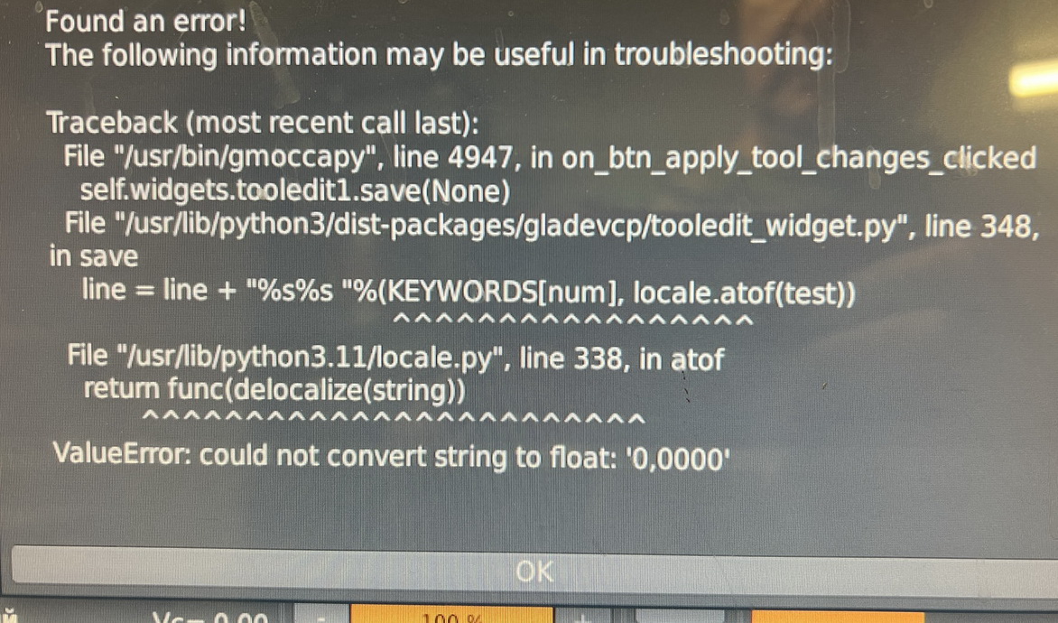

Error adding tool

26 Jun 2024 08:13 #303814
by Serg452
Replied by Serg452 on topic Error adding tool
Hello,
I understand that linuxcnc is free software and no one owes anyone, but can't the developers solve the problem of zeroing the table if they themselves created this error???

26 Jun 2024 10:09 #303820
by zz912
Replied by zz912 on topic Error adding tool
You can remove your localization:
/usr/share/locale/
/usr/share/locale/

26 Jun 2024 18:50 #303837
by HansU
And yes I agree, such destructive bugs should be fixed asap. But as we are doing this in our free time, this time and those time slots are sometimes very small.
I tried to fixed that some time ago, but on that PC I could't reproduce this bug. So this got a little bit out of focus.
Replied by HansU on topic Error adding tool
First, we don't create errors/bugs willfully. That's not a nice wording. This kind of bug seem to arose by the migration from Python 2 to Python 3 (LinuxCNC 2.8 to LinuxCNC 2.9).Hello,
The following user(s) said Thank You: tommylight, Clive S, Aciera

26 Jun 2024 18:50 #303838
by newbynobi
Replied by newbynobi on topic Error adding tool
It seems, that you are using the master branch, aren't you?
If so, you have to calculate with such errors and that solving them could take some tioome, as you are using a development version.
Regards Norbert
Regards Norbert

26 Jun 2024 20:33 #303845
Replied by Aciera on topic Error adding tool
The bug report on github linked above seems to refer to version 2.9.It seems, that you are using the master branch, aren't you?
