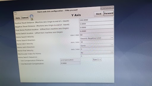

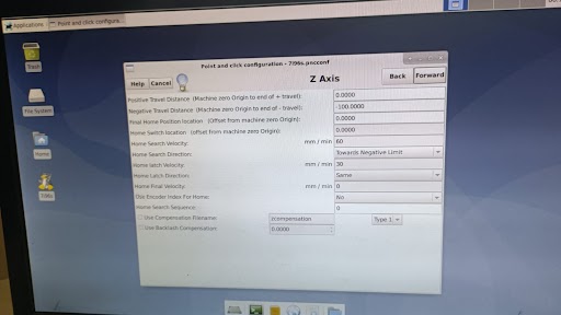

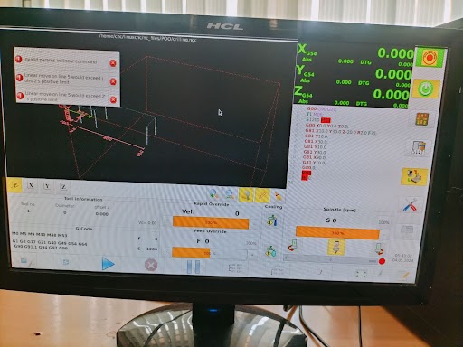

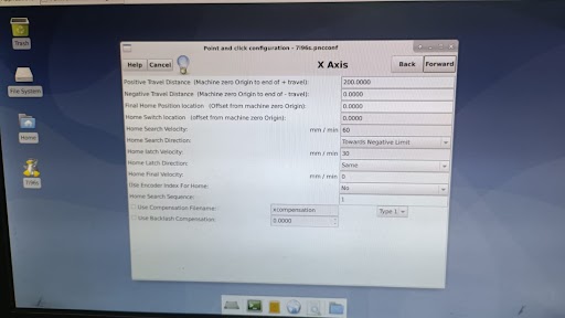

Dear One,
There is an error encountered when Irun the G code, Mcode programs in PnCconf with Mesa 7i96S. Even though all the axis travel distance values are correct, it shows the same errors in all programs. I Have attached the screen shot.
Any help will be highly appreciated.
Linux CNC version 2.8.4
Mesa board : 7i96S
Regards,
Ashwin
Mesa board : 7i96S
Regards,
Ashwin

Pretty much impossible to read the error or the gcode on that screen shot. I gather you are getting limit violation errors for positive Z axis but that is about it.
Please attach the gcode and your .ini/.hal files

You must set G54. Your movements are out of red box.
