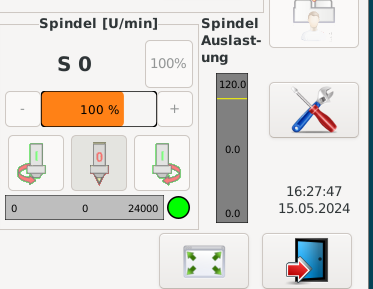

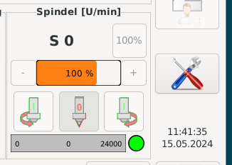

Hallo liebe Leute,
ich habe erfolgreich die spindle_load_bar in Gmoccapy integriert.
Leider verschwindet sie nachdem ich sie in spindle_load.hal verknüpft habe:
net analog3 [HMOT](CARD0).7i76.0.0.analogin3 => spindle_load.bar_spindle_load
Kann mir bitte jemand auf die Sprünge helfen das zu lösen?
Linuxcnc 2.9.2 installiert von der CD am 13.05.2024
Display = Gmoccapy
EMBED_TAB_NAME = spindle_load
EMBED_TAB_LOCATION = box_custom_4
EMBED_TAB_COMMAND = gladevcp -x {XID} -H spindle_load.hal spindle_load.glade

sorry for the worse answare. I try to add some screenshots from the control (spindle_bar.png) . Its not working.
But after I change the path its the same.

1. could you please edit that post and remove the image (just to spare us the nuisance of scrolling past all the nonsense)
2. Try and start LinuxCNC from a Terminal (check the output on startup for relevant error messages):
$ linuxcnc
$ linuxcnc

here is terminal printout

CARD0=<your_card_here>
As an alternative you could also start linuxcnc with the relevant line in 'spindle_load.hal' commented out and then look in the 'halshow' tool for the correct pin name and just use that instead of the ini lookup format you have now.
Replied by Aciera on topic Spindel Load Bar wird nicht angezeigt beim verknüpfen mit Hal-Pin
Looks like you might be missing the card information in your ini file:[HMOT]./spindle_load.hal:4: Ini variable '[HMOT]CARD0' not found.
- Ludwig
- Posts: 36
15 May 2024 14:28 #300683
by Ludwig
Replied by Ludwig on topic Spindel Load Bar wird nicht angezeigt beim verknüpfen mit Hal-Pin
Hello Aciera,
yes, that was the problem.
net analog3 <= hm2_5i24.0.7i76.0.0.analogin3 => spindle_load.bar_spindle_load
Now the spindle load bar is displayed.
