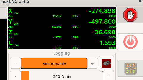

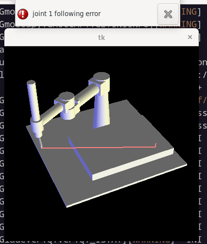

Hello,
I am not sure my topic is in correct category, please move to correct one if it is not.
My testing system is:
- Debian bookworm, kernel 6.1.0-22-rt-amd64
- LinuxCNC: 2.9.2; EtherCAT:  Igh EtherCAT 1.6.0
I test SCARA in step:
- Using sim.gmoccapy.non-trival-kinematics.scara to record position X,Y,Z in 2 positions.
  In simulation, it runs well.
- Create macro position_1 and position_2
- Apply same to real system: it has error of joint as attach photos.
Can you explain why and how to avoid this issue ?.
Thank you.

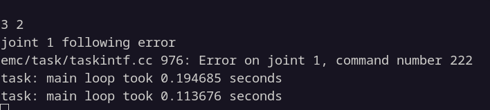

11 Jul 2024 08:56 #304877 by Aciera
Replied by Aciera on topic Gmoccapy SCARA EtherCAT drive - joint error
Have you tried substantially increasing the FERROR and MIN_FERROR values in your ini file?
Since you are using an EtherCAT drive the following error should be handled in the drive already.

11 Jul 2024 11:28 #304897 by Aciera
After I added both of above setting, the issue still happens.
FERROR and MIN_FERROR entries need to be in the [JOINT_n] section not in the [AXIS_l] section:
linuxcnc.org/docs/html/config/ini-config.html
I tried (FERROR; MIN_FERROR) options: (1;0.1) ; (0.1; 0.01) ; (0.01; 0.001)
I would suggest something like (100,100). I presume you are running your drives in position mode and the loop is closed in the drive, if so LinuxCNC really has no part in monitoring following errors at all and setting the values very high will effectively eliminate following error checking in LinuxCNC.
Yes, I think EtherCAT drives handle joint error, but it makes motor shocking so strong & stop suddenly without finishing targeted  position.
If you get drive faults because of following error then you likely need to lower acceleration/velocity values. Also note that if your SCARA pose is close to a singular point  the kinematic model will likely fail and cause large or even infinite angular velocities which will then cause the drives to fault.
The following user(s) said Thank You: DPFlex

12 Jul 2024 09:29 #304973 by DPFlex
Replied by DPFlex on topic Gmoccapy SCARA EtherCAT drive - joint error
Hi Aciera,
I tried (FERROR; MIN_FERROR) = (10;1) first, it runs well. I will try 1-2 days more.
After that I will test your advice of high value (100, 100). Just want to test all scenario for understanding.
