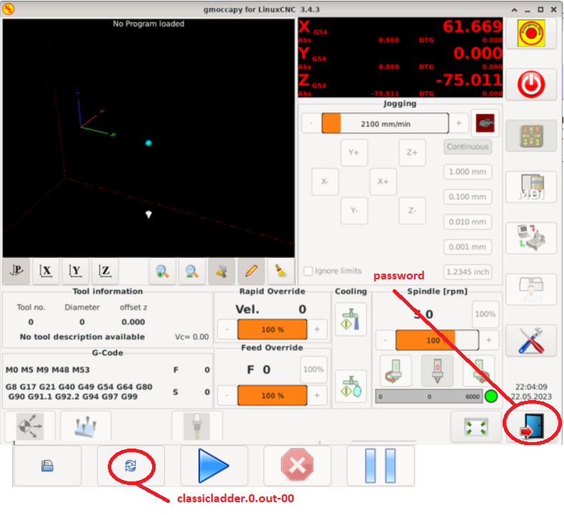

I am making Gmoccapy full screen, but I do not want the user to close the cnc screen without entering a password. should not be able to access anything other than the CNC screen without entering the password. How can I put a password on the exit button? It will be like a settings page and I should be able to set the password.

You would have to modify the gmoccapy source code for this.How can I put a password on the exit button?
you can't as there is no hal pin or state tag that reflects the reload action. You would need to handle this in the GUI source code.How do I check the g code renewal key from Classicladder?

If there is someone who can do this for a fee, I am ready to pay. I think there is someone who can do this, because the people who make this program probably won't have much difficulty in putting a password on the exit.

Replied by rodw on topic How to put a password on the exit button
IN the gmocappy source there is a screen handler written in Python. There is also a glade screen definition, You probably just need to modify the handler for the exit button or even better move it to the already password protected area. Sorry its been 7 or 8 years since I modified gmocappy

I don't have to use gmoccapy, the reason I use gmoccapy is because it automatically reads the g-code file when it first starts and has a file refresh button. I can use another graphical user interface. I have a file whose name doesn't change, for example CutDocument.ngc, but its content does.
I don't want the operator to select the g code file every time. Because the g code file is sent to linuxcnc over the network without changing its name.

05 Aug 2024 07:16 #306970
Replied by Aciera on topic How to put a password on the exit button
Try this:
modify these line in '/bin/gmoccapy':
To this:
Note, standard unlock code is "123", which is displayed in the tool tip text when the mouse hovers over the settings button so you might want to change it to something else. To do that open the .pref file in the machine config folder and find the line 'unlock_code':
To this:
# If button exit is clicked, press emergency button before closing the application
def on_btn_exit_clicked(self, widget, data=None):
# if 'Use unlock code' option is activated on the settings/hardware tab we ask for the code using the system.dialog
if self.widgets.rbt_use_unlock.get_active():
if self.dialogs.system_dialog(self):
self.widgets.window1.destroy()
else:
self.widgets.window1.destroy()Note, standard unlock code is "123", which is displayed in the tool tip text when the mouse hovers over the settings button so you might want to change it to something else. To do that open the .pref file in the machine config folder and find the line 'unlock_code':

I tried it and it was exactly what I wanted. Thanks a lot
